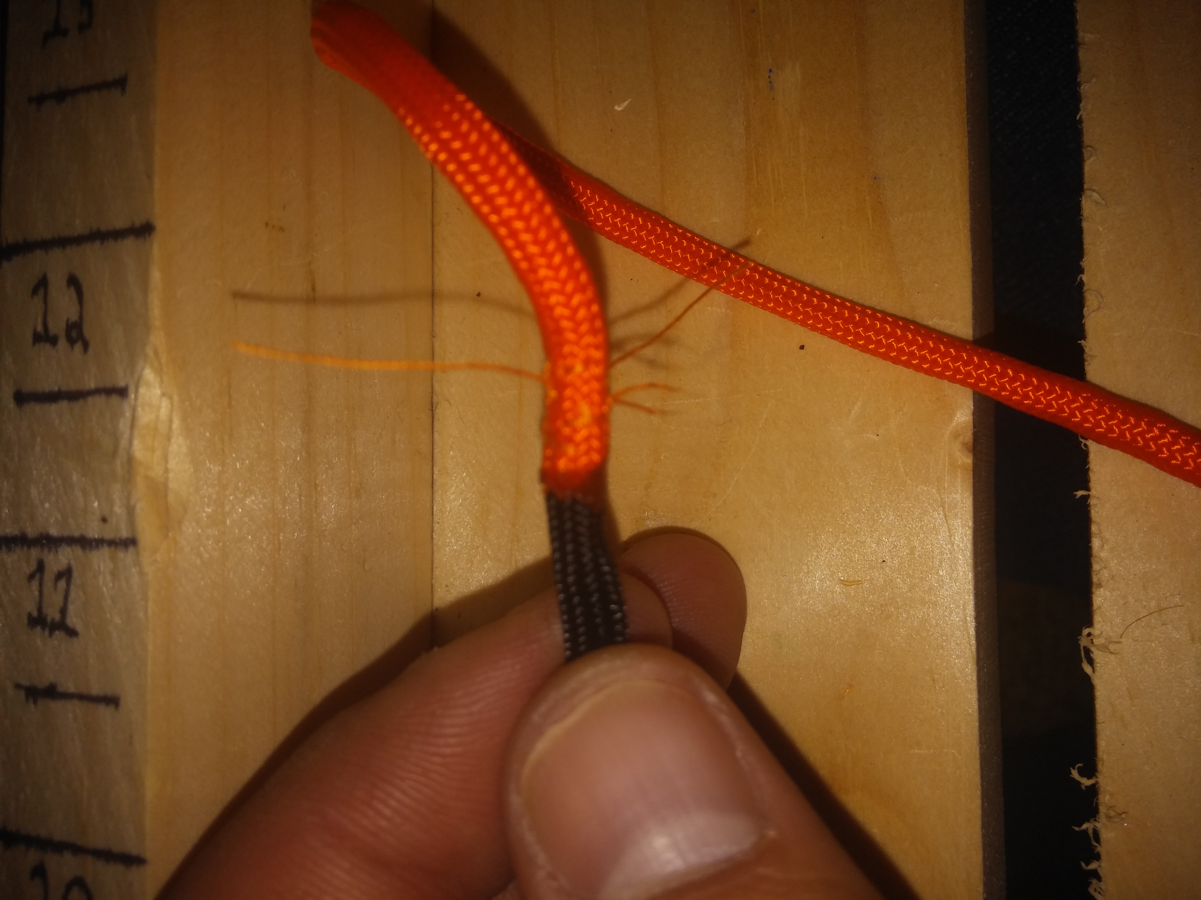

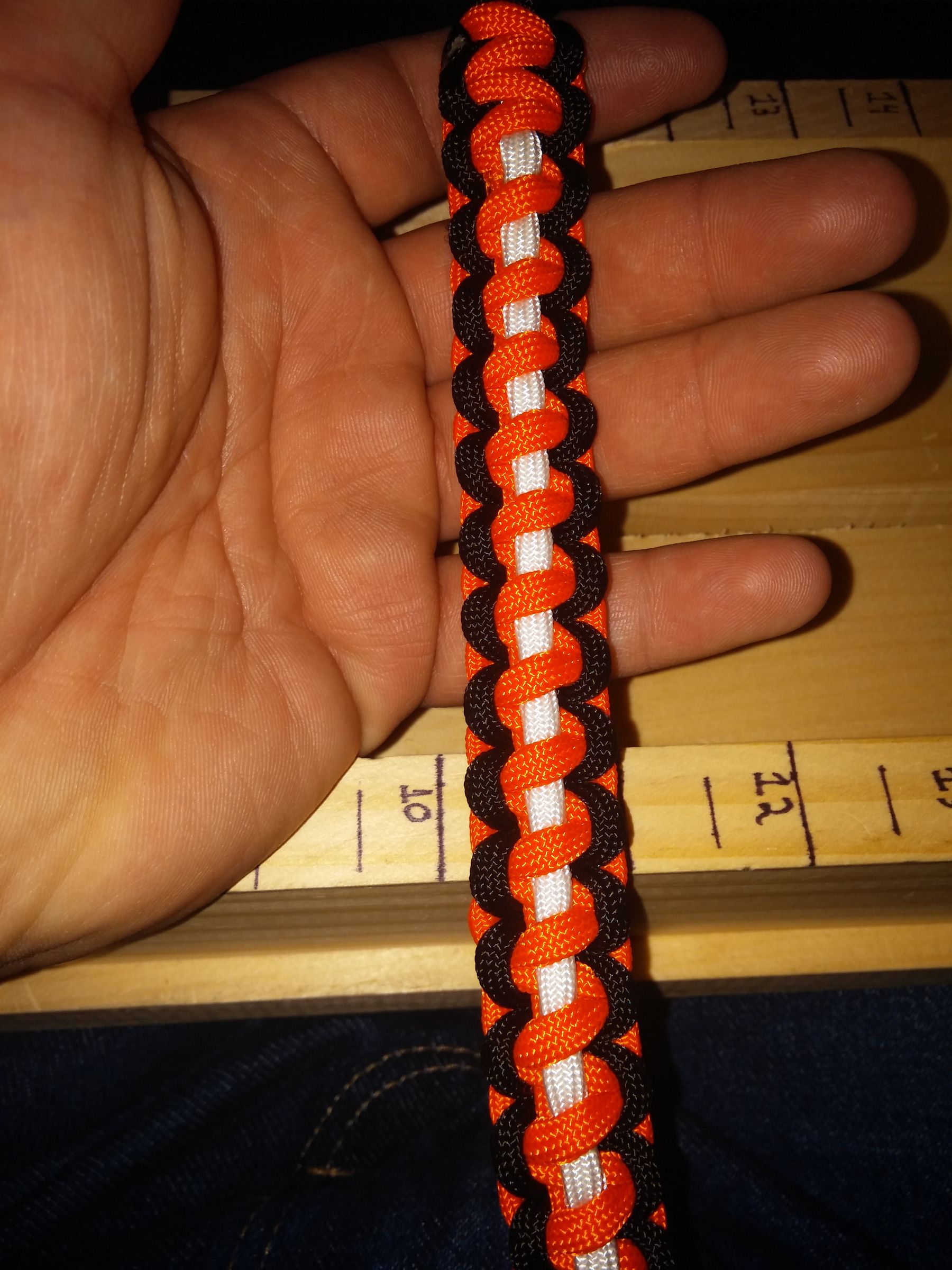

Using a ruler or tape measure, in the rail starting at your top piece, mark out your measurements. I marked every half inch.

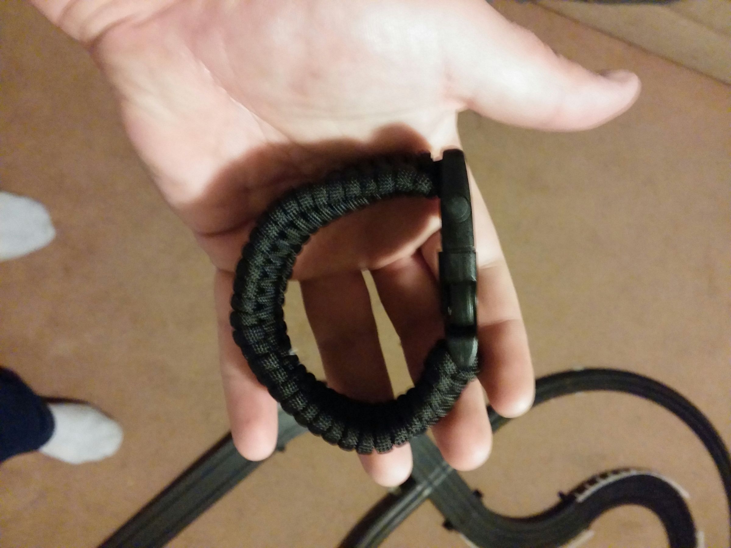

Hopefully my instructions weren't too hard to follow, and now you have a paracord bracelet jig!
