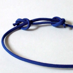

Take 28 inches of paracord or braided cord and slightly melt the ends with a lighter to prevent unraveling. This will be a little long, but it can be shortened later to accommodate the size of your extension cord and tool plugs.
Use a fisherman's knot to make a continuous loop-step 2 pic.
The thumbnail pics show the knot tightened and the finished loop.
