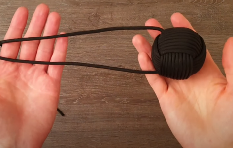

As I previously stated, I will assume that you know how to make a monkey's fist. If you need a refresher then I recommend stephhicks instructable. Follow along to his tutorial until you have your monkey fist looking as above. (If you are using a box with sticks jig, try to use rubber bands to keep the sticks from splaying apart).
Some general tips:
  • The Monkey's Fist is not a difficult knot, but it can be quite repetitive. Just be patient, take your time, and it should turn out just fine.
  • You should aim for an equal amount of loops on each side of the Monkey's fist, but it is okay if you miscount. You do not have to start over. Just make sure you have enough loops to cover the body.

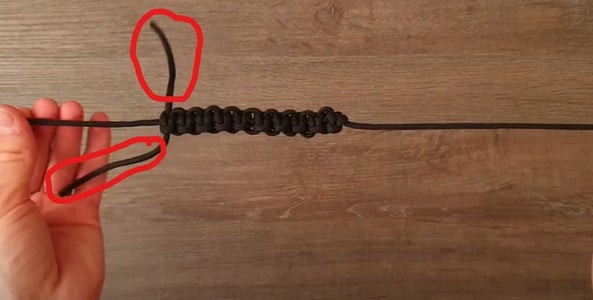

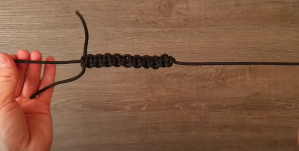

Step 2: The Cobra Knot

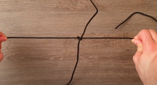

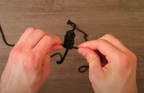

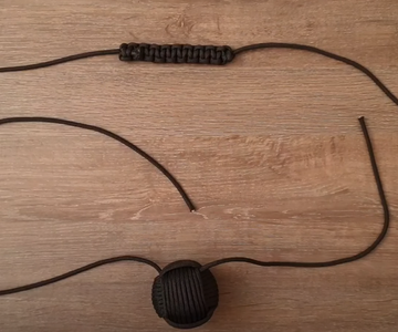

For this part you will follow the tutorial by jseely23 but with one major variation. Rather than weaving around a bent cord, you will weave around a straight cord. The motion will be exactly the same. You will continue wrapping the cobra knot while periodically checking its size with your monkey's fist knot. Once you are happy with its size, you can cut off the two ends you have been weaving and seal them with a lighter. Do not cut the wrong ends. Cut the ends that I have marked in red.

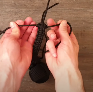

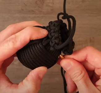

Step 3: Joining the Two Together

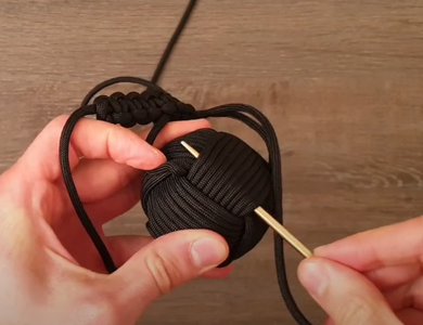

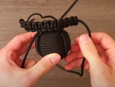

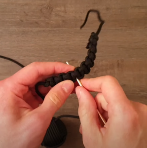

This part is pretty straightforward. You will use the extra cord from the Monkey's Fist Knot to secure the cobra knot on top. Use the paracord fid to lead the cord through the cobra knot and keep securing it until you are happy with it. You can weave under the Monkey's Fist to reach the other side of the Cobra Knot. Once the Cobra Knot is secured, use the remaining cord on the Monkey fist to tie a simple knot in the center of the ball. You can then cut off the excess and seal it with a lighter.

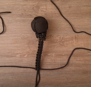

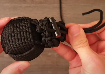

Step 4: Adding the Ferro Rod

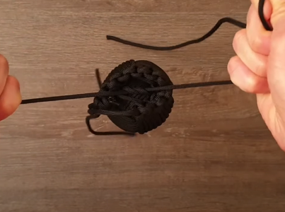

Now you should have two remaining strings of paracord protruding from your build. It is with these two strings that you will attach the ferro rod. This step should be simple, but depending on the thickness of your cord, it may be difficult. For my case, my cord proved to be slightly too large for the rod I had. If you encounter the same problem, I will share the process that I used. If not, move on to the next step.
  • Use the lighter to melt the end of each cord
  • While the cord is still malleable, flatten each end by rolling the fid on it. (You can use a pencil instead)
  • The cord will be HOT. Be careful during this step.
  • After the end has hardened, cut the cord into an arrow. You are essentially making a flat fid out of paracord.
  • Lead each end through the ferro rod. Use tweezers if it doesn't reach the other end.
  • If the end becomes loose, restart this process.
  • Just be patient. Eventually, your results should like like above.

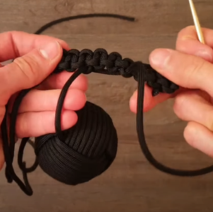

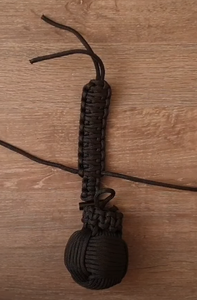

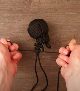

Step 5: The Final Cobra Knot and the Key Ring
You are almost done with the build. Now all you have to do is weave another cobra knot around the two remaining strings. Just to be clear, use a new string of paracord to do this. This will be the color of your handle. The process is the same as for the previous Cobra Knot. Once you get your handle to a length that you are happy with, you can cut off the 2 strings attached to Monkey's Fist. If you want to make your handle thicker, you can circle back and do a double Cobra Knot. After that, cut of your extra cord and seal the ends.
As for the key ring, there is no secret. Put it on the first Cobra Knot wherever you feel that it looks best. I found the act of attaching the key ring quite annoying, but it eventually got on there. Just be patient, you don't want to mess up now. After it's attached. Flip the handle onto the ball and call it a day.
