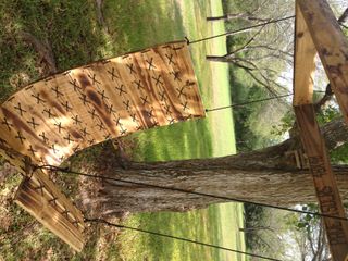

Step 8: Other People's Versions
Many people have made their own versions of this chair. If you make your own, please send me a picture.

Absolutely awesome. Will make this one day (when I finally have a tree big enough to support it). Some food for thought: the current design lets the boards flex vertically, but would be cool to let them flex horizontally as well so it can fit your contours sideways as well (almost like a hammock). Problem with that is that the whole thing could basically sag into something like a deflated balloon when it isn't used, so would be nice to find a way to limit the horizontal flex. If I ever make that I'll come back to post the shots. Thx for the idea!
