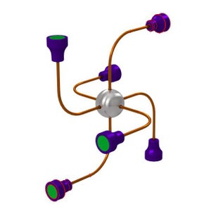

This is a fun, hands-on toy that combines simple mechanics, magnetic interaction, and 3D printing into one eye-catching creation. Designed with a central 3D-printed sphere, paracord legs extend outward along the X, Y, and Z directions, each ending in a uniquely shaped foot that contains a strong magnet. This allows the toy to "stick" to magnetic surfaces in playful, poseable ways. Whether you're into DIY toys or enjoy creative builds, this project is a great way to blend design, movement, and interactivity. Follow along to make your own!

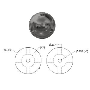

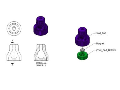

Step 1: Design
CAD Images

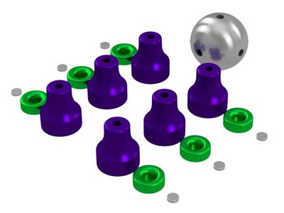

Step 2: Print Parts
Print files. You will need:
  1. Ball (x1)
  2. Cord_End (x6)
  3. Cord_End_Bottom (x6)

Step 6: Add Magnet
Insert the magnet in the Cord_End_Bottom. This should be an interference fit, which will require force. If loose, use glue to ensure it stays in place.
Step 7: Bottom Attachment Cord Feed
Attach Cord_End_Bottom to Cord_End. Depending on your printer/settings, this could be an interference fit. Mine was slightly loose, so I used superglue for the attachment.
Feed the other end of the paracord through one of the holes on the ball.

Step 9: Finished Toy
Ok, so what can you go with this? Unexpectedly, I found the cords support the ball so it can be positioned like a spider-like alien.
