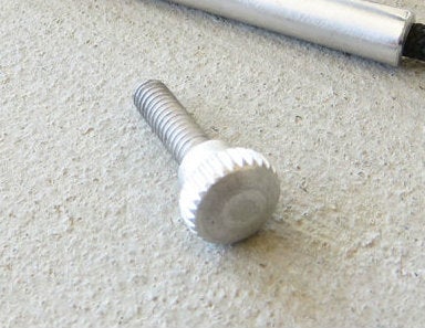

I got the knuled screw from ACE hardware. Item # 1501-K, 6-32 x 9/16" in. - Knurled Thumb Screw
