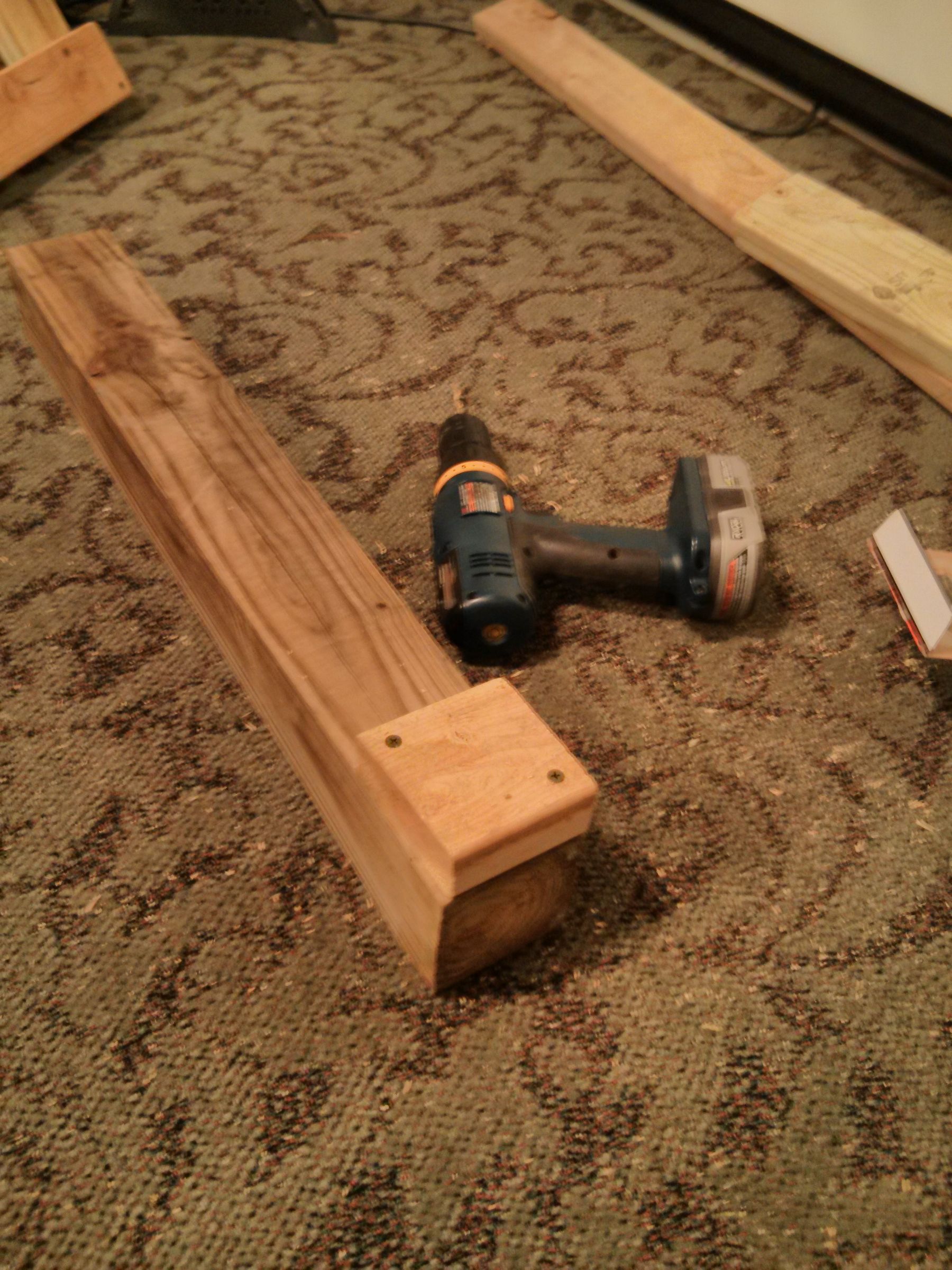

This step is easy. All you need to do is cut 12" (1') off of the leftover piece of 2"x4" twice (for 2 pieces), and screw them into the uprights. I suggest measuring twice and cutting once. I put the 2 screws in each lateral support, approximately 3/4" inch from opposite corners of the square where the two pieces overlap. Also, to attach the supports, try screwing the screws into the lateral piece just enough to poke out the other side. Then set both pieces correctly oriented on a flat surface, and while holding/clamping together, finishing screwing in the screws.
One last note is that I have the lateral supports on the outside of the uprights. I did this thinking that I'd want as much space between them as possible, and also that I might put an angled brace between a lateral support and its upright, but I'm saving that for when I have an easier way to cut the angle (than a hand saw...).
