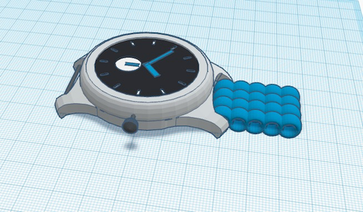

I decided, right there, that what was needed was a little clip which could be woven into one end of a paracord bracelet, to clip over the little bar which holds the watch band onto the watch. Simple enough, I thought. What was needed was to weave the bracelet onto one side of the watch, providing a permanent (for the life of the bracelet) connection between watch and bracelet. Either it would be woven directly to the watch (please see diagram ’04 watch with paracord’ ) or it could be woven around a slim armature, like a toothpick, and later connected to the watch. This is probably the simplest way.

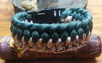

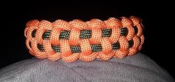

Before properly launching into this Instructable, I wish to thank the following for some of the visual material in this Instructable. Photos of paracord bracelets, and the side-release black nylon buckle come from the Bored Paracord website, and for that I am grateful. The watch illustration used in the Instructable are from the Gallery section of public 3d objects on Tinkercad, this watch model was made by Ilkka Peltola, and I am grateful that it was made public and available for derivative illustration. (Photos 01, 02 and 03 show a typical buckle and typical bracelets. I am sure you don’t really need these pictures for enlightenment.)

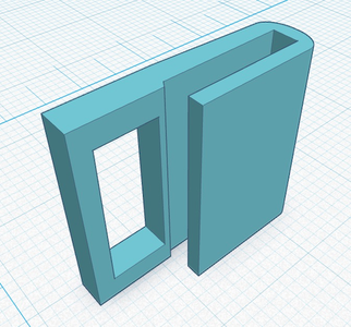

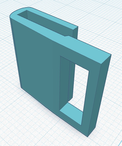

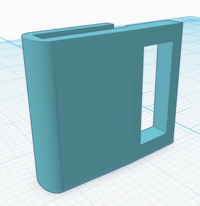

What I imagined in my mind was a clip which simply slid over the little bar, and was woven permanently to the bracelet by way of a rectangular hole in the clip. (Please see diagrams ’05, 06 and 07’ which are named ‘clip 3qtr 1, 2 and 3’. Along with ’08 clipthing cross section.’)
So, there I was, with the notion of a little object, which would need to have a certain amount of strength, whist also having flexible properties. It would need to be robust enough to last a good while, and survive the process of daily clipping on and off the watch. It needed to be dimensionally accurate, because the place on the watch for fitting has relatively small dimensions. It would need to be a plastic of some sort.

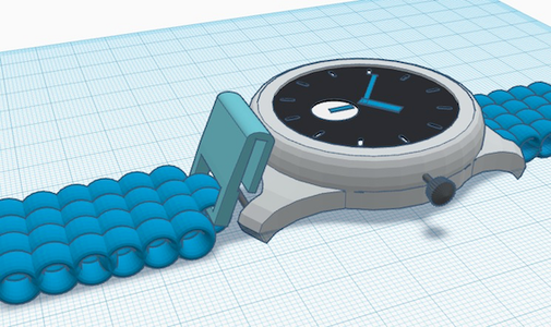

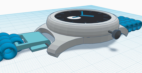

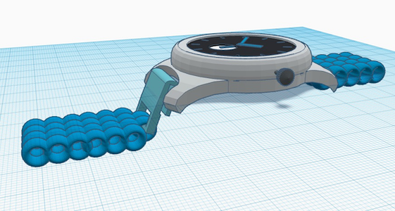

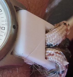

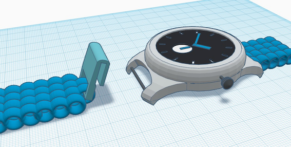

Diagram ’09 watch with clip’ shows the way the clip needs to be rotated before being offered up to the little bar. Diagram ’10 watch fitting clip’ is the juxtaposition of the clip and watch pin prior to fitting. Diagram ’11 watch fitting clip 2’ shows the bar slotting into the clip, and diagram ’12 watch clip fitted’ shows how the clip rotates inline with the weaving when fitting has been accomplished successfully. Photo ’13’ is a picture of the clip as fitted to my watch. I guess white would not be the first colour of choice, but this exercise is about proving a design, not aesthetics.

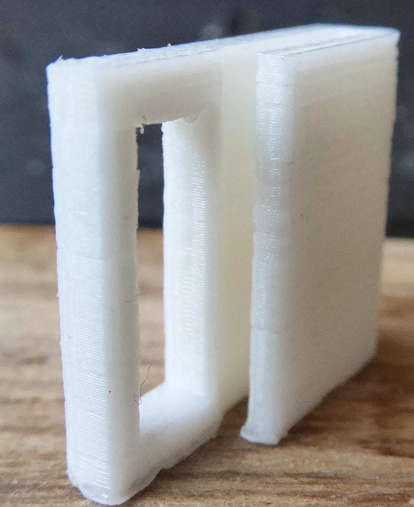

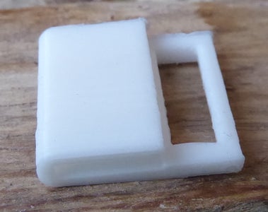

Pictures 14, 15, 16, and 17, show the actual item, at the third level of prototype - ie, ‘final’ version. Picture 18 shows it fitted to my watch, more close up.

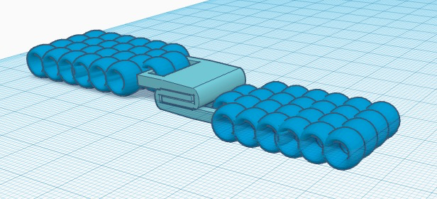

As an aside, I also considered the notion of weaving a little clip into both ends of a bracelet, one opposite way up to the other, such that they ‘mate,’ and form a link which can be opened and closed at will. Again, without the side release buckle, a slight bonus in cordage is achieved. Diagram ’19 bracelet clip,’ shows what I mean.
