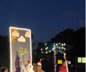

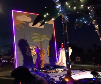

Our concept was to have two surfing dogs next to a pier, to represent the dog beach at Ocean Beach We would also have the logo of the Animal Pad on all sides of the float. We will have truck driven by some HTMMA parents to pull the trailer.
