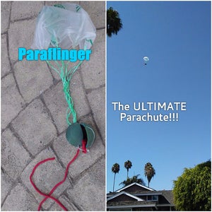

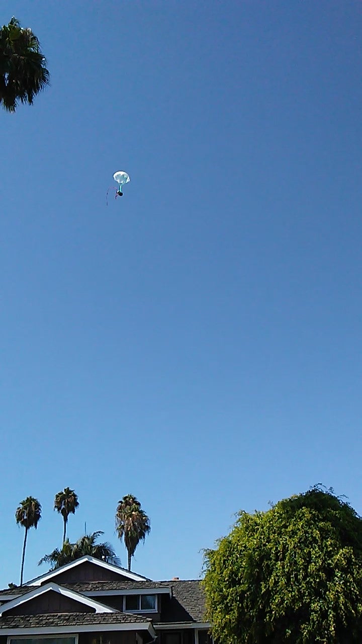

Ever gotten one of those parachutes at an arcade and realized it was so hard to launch? Disappointing, isn’t it? Your problem doesn’t need to end this way. This instructable will teach you how to make a parachute that actually flies. It can soar well over 35 feet in the air and lands gently. BTW, the palm tree in the video is around 55 ft tall. None of the materials require spending any money either.

After your glue dries, take your finished model, and take it for a test flight. The video on how to wrap it is shown above!
