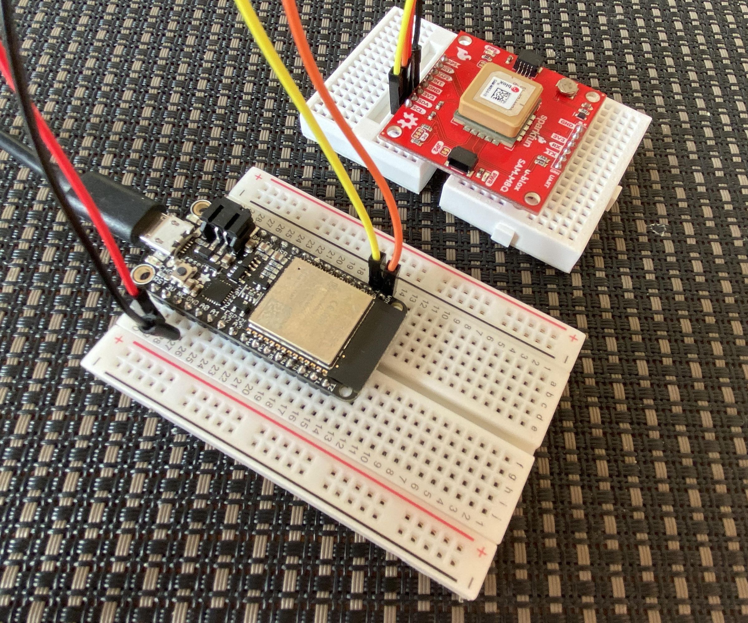

Step 3: Hooking Up Your Hardware
Here is a Fritzing diagram showing how to hook up the BME280 sensor to the ESP32. Note that most ESP32 dev boards are too wide for a standard breadboard. Therefore, wires must be connected under the dev board. Since we're using I2C for this setup, we connect the wires as follows:
SDA -> GPIO21
SCL -> GPIO22
Finally, we of course need to connect 3.3V and GND.
