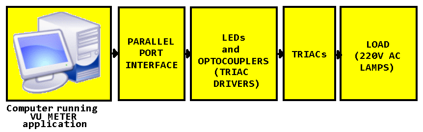

The project uses the very simple audio capturing technique from computer system. A visual basic application is designed which uses the windows multimedia library that is used by the windows operating system to play and capture audio signals through the audio device available on your system. With the help of this library the software samples the audio played through the sound channel and decision making is done to drive the LEDs/lights connected to the parallel port of the computer. The “inpout32” library is used to access the parallel port of the computer. Thus the application drives the LEDs/lights connected to the parallel port after processing the audio signal samples. Due to the limitation of the input/output pins available on the parallel port, only eight LEDs/lights can be driven to display the volume intensity. The software section is thus responsible only for generating logic signals through the parallel port to drive the eight outputs. The status of lights and full VU display for left and right audio channels is displayed on the software interface. The next section is the display section. The logic signals on the parallel port are used to drive the LEDs and opto-couplers section which then will be used to drive the TRIACs and thus driving the mains 220V AC powered lamps. Thus in a nutshell, the logic signal generated by the software according to the audio level on the parallel port will drive the corresponding LED and opto-coupler. The opto-coupler then switches ON/OFF the TRIAC associated with it and lights the lamp. There are two versions of hardware associated with the project for the display section. One uses simple LED array, while the other can be used to drive mains 220V AC lamps.

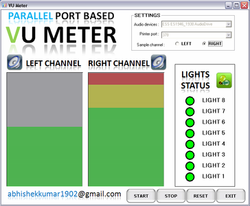

On the top-right of the application, a settings frame has been drawn which holds the audio device selection combobox, parallel port selection combobox and the left or right channel selection option buttons. The audio device selection combobox can be used to select one of the audio hardware drivers available on your computer which you want to sample the audio signal from. The parallel port selection combobox can be used to select the parallel port physical address on your computer. And as the 8 LEDs/lights on the parallel port can only display one of the left or right channels only, so the sample channel option buttons enables you to choose from either the left or right channel of your audio signal to sample from.
On the mid-left of the GUI, two LED meter components have been drawn which are used to display the sampled audio intensity from the left and right channels of the audio signal. This led-meter component is derived from the “LedMeter.ocx” activex object. On the mid-right of the GUI, eight circular shapes have been drawn which imitates the status of the eight LEDs/lights connected to the parallel port. On the very bottom of the GUI, four buttons named “START”, “STOP”, “RESET” and “EXIT” will let you start/stop the VU meter, reset the outputs and exit the application.

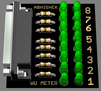

As capturing and level comparison of the audio data has already been taken place on the computer side, only display hardware is now required to display the volume levels. Two circuits have been designed here for the purpose. The first is very simple one that uses an array of eight LEDs connected directly to the parallel port data outputs. This circuit has both its advantages and disadvantages: It is easy to build, does not use mains voltage, and it does not endanger your parallel port in any way. However, the LEDs are not as bright as normal mains powered lights, so you probably can't use them at a party. Also you can't use super bright or high current LEDs as those LEDs draw too much current, and the port will not be able to power them. This circuit for this LED based display section is shown in the above figure.
The 8-bit data outputs are taken from the parallel port via the pins D0, D1, D2……D7 those are physically located on pin number 2, 3, 4, 5…...9 on the DB25 parallel port as shown in the circuit. Pin number 18 to 25 are the ground pins connecting to the common cathodes of the LEDs series. Two LEDs in series along with a current limiting resistor are connected to each bit output on the parallel port from D0 to D7. Hence for each level incremented in the audio intensity, two LEDs will glow. It is up to the choice of user only, he can use only one LED for each channel instead of the two or moreover can also increase the number by using a current driver circuit like ULN2003, etc or transistor based drivers. It is important to note that each pin on the parallel port can not source more than 20mA of current so if you use more LEDs, you have to add a driver circuit for the same.

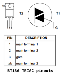

Again, the 8-bit data outputs are taken from the parallel port via the pins D0, D1, D2……D7 those are physically located on pin number 2, 3, 4, 5…….9 on the DB25 parallel port as shown in the circuit. Pin number 18 to 25 are the ground pins. Now, to drive the mains rated AC lamps, we use the TRIAC here as a switch. To drive the TRIACs and to isolate our +5 volt parallel port logic circuitry, we use the opto-coupler MOC3041. An opto-coupler is a device which is used to keep low-voltage circuits such as the very delicate parallel port and high-voltage (mains) circuits apart. They generally consist of 1 or more Infrared LED's pointing at a detector. The detector is used to trigger the TRIAC. Sometimes, as is the case with the MOC3041, there is a Zero-crossing detector also incorporated into the same package. Pin number 1 and 2 of the MOC3041 opto-coupler has the LED which acts as a signal transmitter inside the opto-coupler. We connect an external LED in series with this opto-coupler LED along with a current limiting resistor directly to the data lines of the parallel port for each of the eight output channels. The ground lines are shared by all the cathodes of opto-coupler LEDs and connected to pin 18 to 25 of the parallel port. The other side that is the detector side of the opto-coupler at pin number 4 and 6 is connected to the TRIAC pins via 470 and 330ohm resistors as shown in the circuit. The traditional way of proportionally controlling mains electricity is by using a TRIAC. These 3-terminal devices can be triggered to act as an on-off mains switch. Once they are turned on, they stay on until the voltage across them is reversed. This will happen every half of an AC cycle. To accurately control the power you need to know where you are in the mains cycle, so you can turn the TRIAC on in the appropriate place. However the purpose of ours is just to ON/OFF the load, and the zero crossing detector built already onto the MOC 3041 opto-coupler serves the purpose for us by switching the TRIAC on every reverse cycles of mains AC according to the control signal input. BT136 or any general purpose TRIAC with rating more than 4A, 400V can be used here. A combination of 39 ohm resistance and 0.01uF, 400v mains rated capacitor is used as a protection for the TRIAC, however they are optional but are recommended to be on the safe side. The correct pins of the BT136 TRIAC are shown in the second figure.
To be on the safe side, it is recommended to use 0.5 watts resistor for the 470 ohm and 330 ohm value ones that connect the MOC3041 opto-coupler and the BT136 TRIAC, however 0.25 watts will also work fine. The mains 220V live input is fed to the MT2 pins of all TRIACS in series with an 8A fuse as shown in the circuit, while the MT1 pin goes to one of the terminal of the lamp and other terminal of the lamp goes to the mains neutral wire.

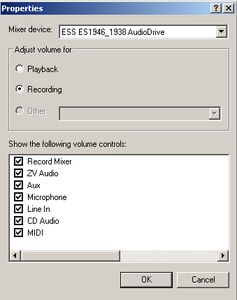

Then go to the “Options” menu in the menu bar of the volume control window and choose “Properties”. The following screen will appear as shown in figure 2.

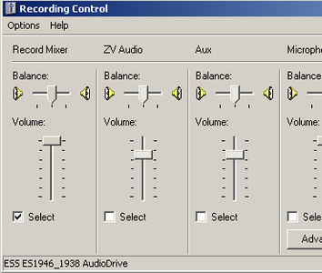

In the “Properties” window, click the “Recording” option button and then from the list below, check mark on “Record Mixer” and click on OK. Now the following screen will appear as shown in figure 3.
Now mark the “Select” check button of the Record Mixer section and set volume to maximum as shown in the screenshot. Run the VU Meter application. In the application, on the top-right settings frame, select the default audio driver hardware of your computer. Then select the physical address of your parallel port on the computer(default 378). Select either the left or right channel to sample, you can change this afterwards also. Now click on “START” button. You will observe that the green level in the LedMeter on the software will be right in the middle. Now play any song or anything on your computer, you will notice the LedMeter bars and Lights status LEDs on the software will follow the beats of your audio being played and the same sequence the display section consisting of the LEDs/AC lamps will follow.
