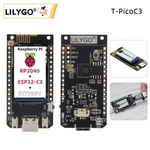

All you need is a T-Pico C3 board, less than 20$.
This small board has 2 microcontrollers, a TFT display, one adressable red LED, 2 push buttons, a USB-C port, a battery connector, and a reset button. There are also 2 other LEDs (green and blus) that are not adressable, as we'll see in step 1.

Step 1: Microcontrollers and MicroPython
Two MCUs, but only one COM port ! How does it know that we want to program one or the other?
It takes benefit of a feature of the USB-C, that can detect the cable's orientation. As you can see on the figure above, if the cable is connected with one side up, it will address the RP2040, and if it is flipped it will address the ESP32. In the first case, the blue LED is lit, in the second case it's the green LED.
You can stick a marker on one side of the USB cable, to identify it more easily.
The board has also some IO that we can use, but only a few are for the ESP32, the others are for the RP2040. The reason is that the designers of the board had in mind that we would only use the ESP32 as a WiFi peripheral for the RP2040. It's a pity, because the ESP32 is so much more powerful than only a simple wireless thing...

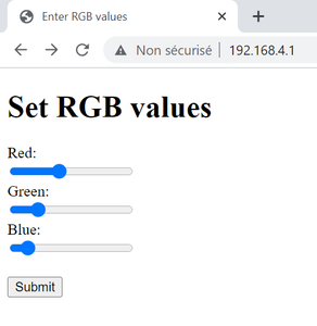

Step 4: Web Server
It would be nice also to be able to interact with the device, and control some parameters that could be easily verified. One way to do this is to take advantage of the WiFi capacities of the ESP32 to have it home a web server.
To do this we need to create a WiFi access point on the ESP32, and create the web server. For the WiFi, the following code creates a WiFi access point, call ESP-AP that you can find using your smartphone or computer WiFi scanner:
import network
# Create access point
ap = network.WLAN(network.AP_IF)
ap.config(essid='ESP-AP') # Change the name as you prefer...
ap.active(True)
# Print the SSID
print("Connect to: " + ap.config('essid'))
No password required to connect. The documentation for the network library is available here.
For the web server, I chose a very light library called microdot. To install it on your device, connect it on the ESP32 side and copy the file microdot.py available here in the ESP32 drive. That's all for now : you can run the first example of the library:
from microdot import Microdot
app = Microdot()
@app.route('/')
def index(request):
    return 'Hello, world!'
app.run(host='192.168.4.1', debug=True, port=80)
If you are connected to the previous access point and open your browser at the URL: http://192.168.4.1 you will see the message 'Hello, world!' (hopefully).
That was the most basic web server in the world, we need something more interesting. Actually, the app.run instruction is an endless loop: whatever comes after this line is never executed. That's not what we want.

Then go back to the RP2040 side and run the previous code bgColour.py. Connect to your access point (ESP-AP), open your browser and type the URL 192.168.4.1: you should see the web page as shown on the picture above. The HTML code for the web page is defined in the htmlRGB variable: there are 3 sliders, one action button and the associated action is:
action="/rgb?r=red&g=green&b=blue"
It calls the route defined here:
@app.route('/rgb')
which get the 3 values of the colour's components, assembles a message (ending with the character '=') and sends it over the UART to the RP2040.
Just select the 3 values for the RGB components and hit the "Submit" button: you will see the colour of the display change. Additionally, the server and Thonny will display the message that is sent through the UART, such as:
Red: 17 Green: 47 Blue: 215 =
This has set the bases for asynchronous multithreading on the ESP32, which we will use in the next steps...
