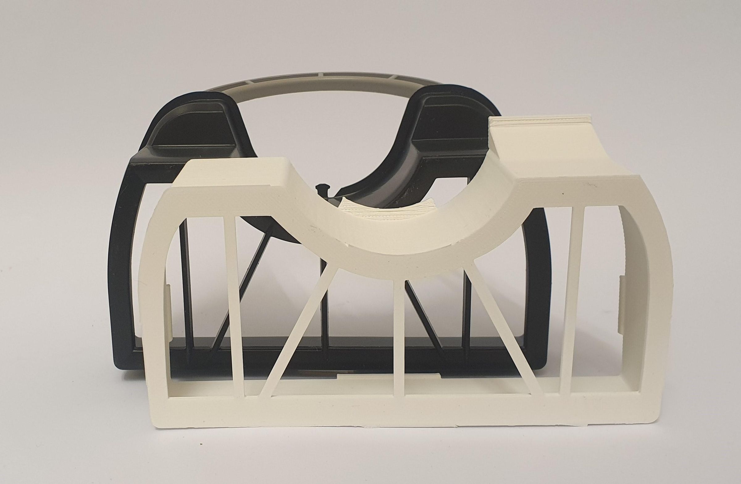

  • self-made 3D printed parts (the wheel adapter)
  • or parts from other brands/versions to your (broken) electronic device (hose adapter).
In what cases is this method applicable?
This strategy is most applicable for parts that have a similar shape and connection method between different brands and versions. The examples in this strategy are for the front wheel and hose connection of a vacuum cleaner.

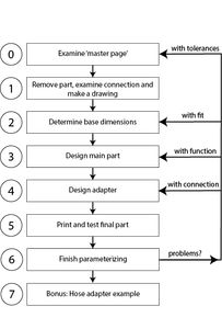

Step 1: Remove Part, Examine Connection and Make a Drawing

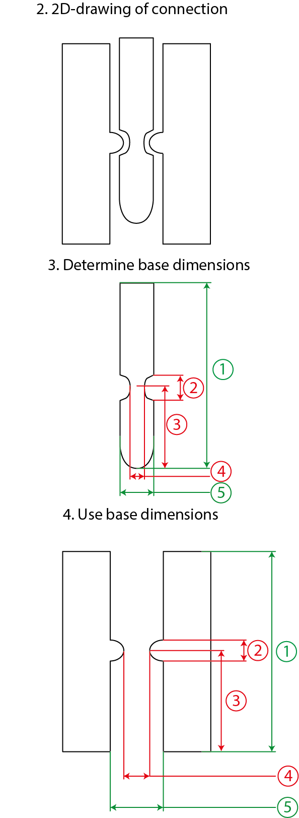

For designing a parametric design it is most important to fully understand the connection between the parts. So the first thing you should do is analyse the connection and make sure you understand the principle behind it.
Most connections make use of some kind of elastic deformation, like snap-fits. For more commonly used connection methods click here.
Once you understand how the connection works, make a 2D drawing of it. This will help you discover whether or not you completely understand how the connection works and show the variables that are important within this connection.

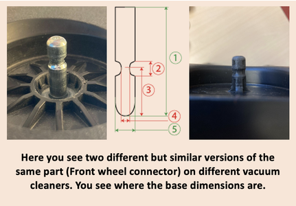

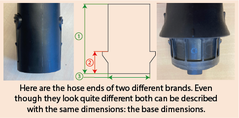

Step 2: Determine the Base Dimensions/input Parameters
Using the 2D drawing created previously, you will be able to determine where the base dimensions are. We refer to base dimensions to being the measurements that are variable, so users of the file can change them to fit their product.
Most parts will only require 3-5 of these base dimensions. The base dimensions for the wheel adapter are shown in the figure above:
  • The green dimensions are ones needed to make the part fit into/onto the vacuum cleaner.
  • The red dimensions are the ones used to make the connection work.
Having access to different brands/versions of the product you are trying to fix may be helpful in this stage, since they should use the same or similar dimensions.
Once you have determined the base dimensions, give them recognisable names to help prevent confusion later on. (In the pictures above this the dimensions have not been named to keep the pictures clearer.)
And lastly measure these dimensions.

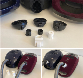

Step 3: Design Main Part

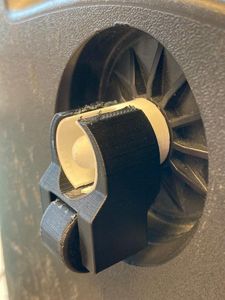

For the example shown here, it was more useful to divide it into two different parts: the main part and the adapter.
This was done to allow for easier adaptation to different brands/versions because reprinting only the adapter takes far less time than reprinting the entire part.
The main part is the component that replaces the original function. In this case the main part is used to make sure the vacuum cleaner can roll smoothly.
Then the adapter is used to make the main part fit into/onto every different brand/version.
So when designing the main part it is important to make sure the adapters can be fit tightly into the main part.

Step 7: Hose Adapter Example
This process was also followed in order to design a hose adapter file. This file allows you to connect any brand/version of hose on any brand/version of vacuum cleaner.
This part was basically two adapters on top of each other, and therefore did not need to be divided into two individual parametric parts as all of the model would change no matter on what brand/version it is used for.
In this case the part also needed quite a bit of strength to make sure it wouldn't break. So it was not divided into two parts like the previous example, as this would most likely reduce the strength significantly.
The snap-fits were not included in the base dimensions. This was due to the fact that the measured snap-fits all had very similar sizes. Therefore, it was possible to use the same values for all of the snap-fits. This was a useful discovery as the users don't have to go and measure their snap-fits which may be difficult without specialised tools.

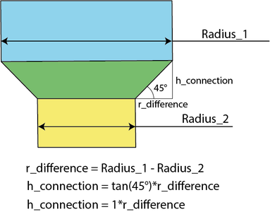

So as mentioned this part consists of two adapters:
  • The adapter the hose has to fit into
  • The adapter that has to fit into the vacuum cleaner
These adapters have the same shape, but not the same diameter. So to combine these two adapters into one part, extra material was added in between. This extra material was added with a 45 degree angle to make sure it would not require support.
