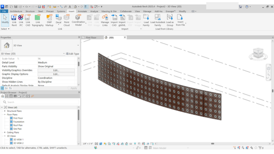

Step 5: Create a Curtain Wall & Import Panels
Now that the curtain wall family has been saved, it can be added to a curtain wall in Revit.

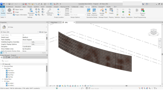

Draw a curtain wall of your desired length and height. I drew a curved curtain wall for fun.

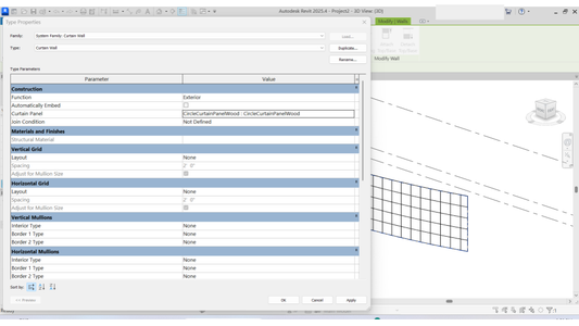

Select the curtain wall. On the properties panel select Edit Type. Duplicate the curtain wall type and name the new curtain wall type. Select okay.
Properties → Edit Type → Type → Duplicate
Set the vertical and horizontal layout and spacing of the curtain wall to your desired size. I created 2’ x 2’ curtain panels. Keep in mind that as the number of panels in a wall increases, the harder it will be for Revit and Dynamo to process the information in the revit file. If you are designing a wall with hundreds or thousands of small curtain panels, make sure you frequently save your work, and consider testing your design on a smaller prototype wall first.
Type Parameters → Vertical Grid → Layout
Type Parameters → Horizontal Grid → Layout
Now, change the curtain panel value to your concentric circle curtain wall family.
Type Parameters → Construction → Curtain Panel
Select Okay or Apply and the curtain wall should populate with curtain panels.
If the curtain wall is covered in a mess of giant circles, or the material of the curtain wall has changed but there are no visible circular cutouts in it, double check the inner and outer circle diameter parameters are set to values at a reasonable size for the size of panels being used. For example for a 2’ x 2’ panel arrangement try setting the outer diameter to 1’ and the inner diameter to 0.5’.

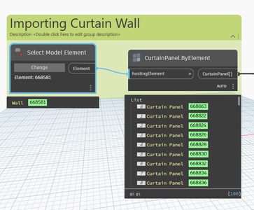

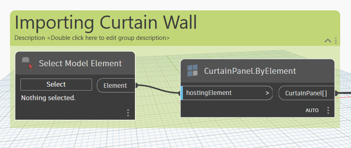

Connect a Select Model Element node to a CurtainPanel.ByElement node.
Select Model Element selects an element from a Revit model.
CurtainPanel.ByElement generates a list of all of the individual panels in the selected curtain wall.
To select a curtain wall click on Select on the Select Model Element node then click on a curtain wall within your Revit model. Click run to run the program.
After running the program if you hover over the 3 dots in the corner of each node, information about the curtain wall should appear.
Step 8: Outer Circle Diameter Randomization
To randomize the outside diameter of the inset circles:
Please refer to the reference photo above for more information.
Connect a Code Block to a List Create node. List as many outside diameter values (in decimal feet) as you want in the code block, each on a separate line and followed by a semicolon. Connect these values to the List Create node to create a list. Use the small + and - signs at the top of the List Create node to expand and contract the list length.
Now create 2 List.Count nodes. These nodes will output the number of items in a list. To determine the number of outer diameter values connect the outer diameter List Create node to one of the List Count nodes.
Connect the CurtainPanel.ByElement node to the other List Count node to count the number of curtain panels in the wall. Use a / (division operator) node to divide the number of panels (x) by the number of diameters (y) by connecting the panel number List Count node to x on the / node and the diameter number List Count node to y on the / node.
Create a List.Cycle node. Connect the outer circle diameter List Create node output to list on the List.Cycle node. Connect the / (division operator) node output to amount on the List.Cycle node. List.Cycle will output a new list of diameters that contains the same number of list items in it as there are curtain panels by repeating the list made by the List Create node until the correct number is reached.
To randomize the list that List.Cycle output connect it to list on a List.Shuffle node. Create an Integer Slider to connect to seed on the List.Shuffle node. This Integer Slider will function as a seed for List.Shuffle enabling us to create pseudo random but reproducible diameter sizes.

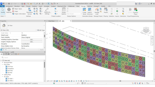

To output this pseudo random arrangement back into the Revit model we can use Element.SetParameterByName. Connect the CurtainPanel.ByElement node to the element input on Element.SetParameterByName. Create a Code Block. On the Code Block type the name of the parameter outer diameter is assigned to on your model in quotation marks followed by a semicolon, I used the parameter “OuterD”. Connect the parameter name Code Block to parameterName on the Element.SetParameterByName node. Connect the list generated by List.Shuffle to value on Element.SetParameterByName.
When the program is run the outer diameter of the circles should now be varied randomly between the diameter sizes listed. This program randomly arranges equivalent numbers of listed diameter size.

When the program is run the inner and outer diameters should now be randomized.

When the program is run the panel’s material should now be varied randomly between the given material types.

When the program is run the inset circle’s material should now be varied randomly between the given material types.
