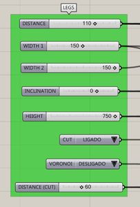

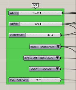

Step 2: Editing
If you are not familiarized with the software, it could look pretty confusing, but the elements that should be edited are all grouped in green box. It safe to change this values freely, but if want to actually send the file for fabrication is best to make sure that you chooses will not result in a poor structure.

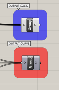

Step 3: Finishing
When you are finishing editing you can simply bake the red box element, to generate the 2D file in Rhino, and export it in the format that is required. This project is only a experimentation and its need to bee appropriated, please feel free to help to evolve and refining this idea.
