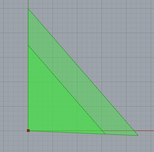

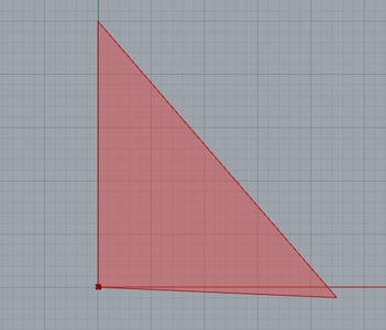

Step 1: Generating a Triangle
First, we start off with making a generic method to create a triangle based on 2 vertices and 2 angles. Since the mask will be composed of various triangles at varying sizes, we want the triangle generation to be entirely parameterized.
We also want to hollow the triangle out to reduce print time and filament usage, and at the same time increasing breathability since it's intended to go on the outside of a mask. The scale of the inner triangle is easy to create since each edge will simply be a proportion of the original. However, it is currently not offset properly from the outer triangle.

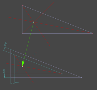

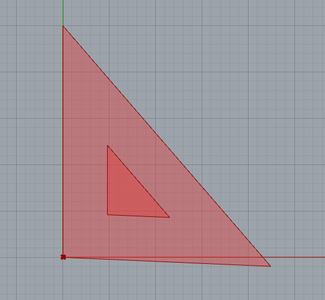

Step 2: Offseting Inner Triangle
Some searching around showed us that it would've been a good thing to pay attention in geometry class.

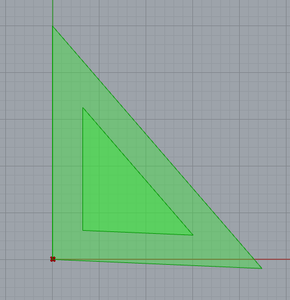

The vertices of the inner triangle will always fall on the lines that bisect the triangle, and the intersection of the bisectors is the incenter. To determine where the incenter is, we can use our generate triangle function with the same vertices but half the angles, which will generate the third vertex, which is the incenter.
There is also a formula for computing the incenter with 3 vertices of the triangle:
for side lengths a, b, and c and vertices A, B, and C, where a is the side length between A and B
incenter = ((a*x_A + b * x_B, c * x_C) / (a + b + c), (a*y_A + b*y_B, c*y_C) / (a + b + c))

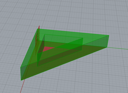

Now that we have both the outer and inner triangles, a boolean difference will hollow out the triangle.
Step 3: Extruding and Printing
Extruding and then printing our hollowed out triangle proves that we might've made the triangle too thick to be on a mask. Since everything is parameterized, that was an easy change.

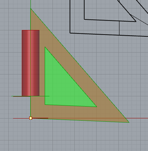

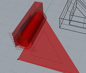

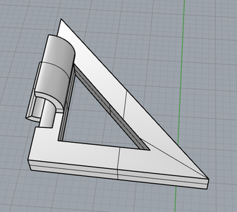

Step 4: Adding Cylindrical Connector
We want the angles between different triangular faces to be adjustable, so a hinge mechanism might be a good solution to this. We start by adding a cylinder to the side of the triangle.
The first test print showed that the radius of the cylinder wasn't enough.

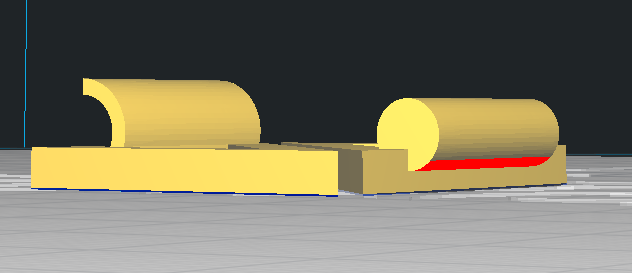

Step 5: Creating the Cylindrical Slot

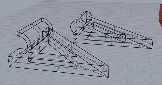

Next, we want to create a cylindrical slot on the piece that neighbors the piece with the cylindrical connector. Be creating a larger cylinder with some tolerance then cutting away part of it, we have the hinge mechanism.

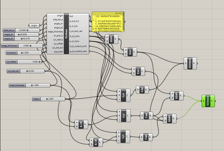

Step 6: Baking and Slicing
There were more nodes than I though would be necessary for creating the hinge geometries. It is unexpectedly hard to design a good hinge.
We kind of expected the slicer to not like the overhangs created by the cylinders, but it will probably be fine.
Step 7: Testing the Hinge
While the hinge does work, and is able to hold its shape after adjustment, the attachment isn't very secure when adjusting the angle. To mitigate this, we can try making the slot protrude from the side of the triangle more, and make a slit on the inside of the cylinder to allow for fuller clamps and rotations.

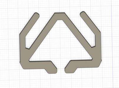

Step 10: Iterating Over Strap Clip
From the first iteration of the strap clip, I noticed that the hollowed part of the clip can conveniently loop an elastic band through to form the head band at an angle.
For the second version, we enlarged the hollow part to fit the width of the elastic band. The prongs are also angled inwards and a gap is added at the bottom to slip the band through.
To get the strap actually working and wearable, where the tension in the head strap would be able to hold the mask in place, a second head strap is probably necessary to counteract the tension from the first strap to keep the strap clip stable.

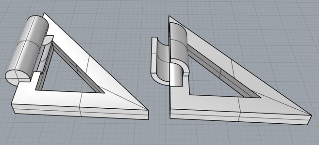

Step 12: Iterating Over Hinges
Now, we come back to the hinges. Somehow this turned into a painstaking pursuit for good hinges, which is important to obtaining the freedom of movement but also the rigidity necessary to form a mesh with these triangles over the mask.
We'll talk about all the problems that caused subsequent iterations in the next step.
Hinges are tricky.

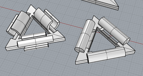

Step 13: Testing Different Hinges
Here are some of the problematic iterations:
  1. not enough rotation allowed for slot --> generate slit next to shaft for the slot
  2. not enough tolerance on slit --> add more tolerance
  3. slot too fragile, prone to snapping when rotating hinge --> increase slot wall thickness
  4. slot too robust, prone to snapping shaft when rotating hinge --> increase shaft contact area with face and decrease slot length
These triangular pieces ended up producing a hinge with robust enough rotation and can kind of hold its shape.

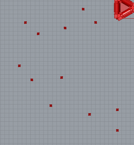

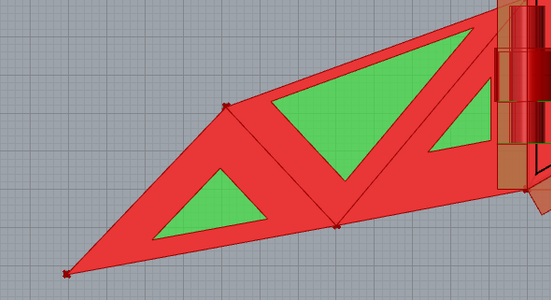

Step 14: Generating Triangles From Points
Since we originally wanted to compose the physical mesh by using triangles of varying sizes and shapes, I tried generating the triangles and their connecting hinges through grasshopper from a cloud of points with shared edges.
While I was able to parse the points and get the outer triangles generated in the right locations, the inner triangles were offset, which reveals that our incenter algorithm was probably problematic.
