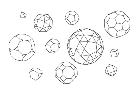

Step 1: 3D Design
I built a Fusion360 sketch and defined my parameters as follows:
- I started to make parameters to my design
- Then I start to Draw my Basic Shape (I Will call It SIP)
- Then I start to make the Stick
- After I finished the design I Export the file as a DXF to put it in the Laser Cutting Machine

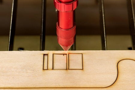

Step 2: Laser Cutting
I prepared the file I want to cut on Laser Works or Coral Draw
Then I Put the Files Into the LASER Cutter
For our Laser Cutter, The Power of the Laser was 60 watt
So The Speed and Power I will choose depend on the Power of the tube of the laser
For PlyWood 3mm :
Cutting : Speed (25mm/s)---Power (Min:65%---Max:65%)
For PlyWood 6mm :
Cutting : Speed (15mm/s)---Power (Min:75%---Max:75%)
Engraving : Speed (300mm/s)---Power (Min:30%---Max:30%)
