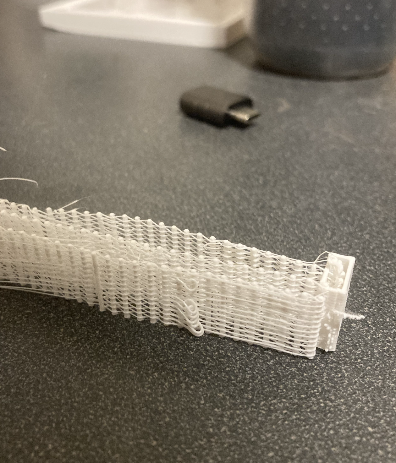

The first step in my design was creating the light shade that the plant holder would rest on top of. To design it, I used Grasshopper and an extension called Weaverbird. I first created two circles in Rhino3d and connected them to generate a cylinder in which I would generate the voronoi design on top of. After playing around with the components in Grasshopper, I settled on this final design. I attempted to mimic the complex design of the cellular lampshader, but I faced issues of Cura needing to add in supports to print the model, which I didn't want. Once the design was completed, I moved on to designing the other components of the plant holder.

The final result! There are a few artifacts that were generated when printing the parametric light design, but they are pretty minimal and not noticeable unless a closer look is given.
