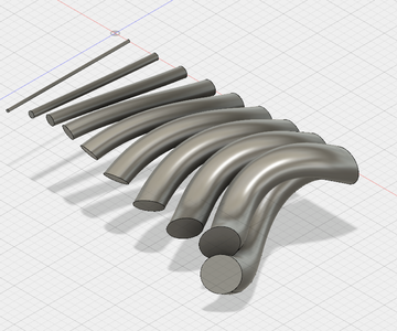

points = adsk.core.ObjectCollection.create()Step 2: Sweeping the Splines Into Solids
SpiralSweepSolids.py
Building on this collection of spiraling splines this sketch creates a circle at the beginning of every spline and sweeps the circle down the spline to create a new solid
# Create a circle at the beginning of the spline
circles = sketch.sketchCurves.sketchCircles
circle1 = circles.addByCenterRadius(points[0], j/(tubeCount-2) + 0.1)
# Create a sweep input
prof = sketch.profiles.item(j)
path = rootComp.features.createPath(spline)
sweeps = rootComp.features.sweepFeatures
sweepInput = sweeps.createInput(prof,path, adsk.fusion.FeatureOperations.NewBodyFeatureOperation)Step 3: Refactor and Play Around
