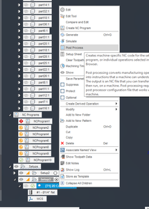

Right click your 2D contour tab and select post processing to program the code
