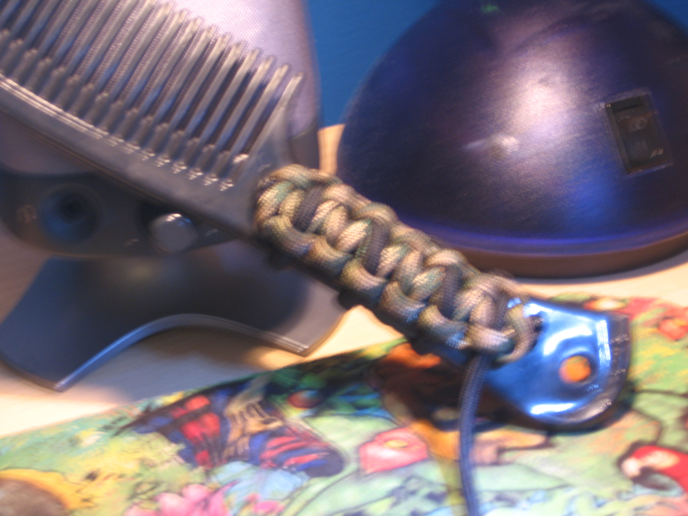

Lastly, feed the wires through the holes and bend the tips at 90 degree angles. (Sorry these picture is really blurring).
