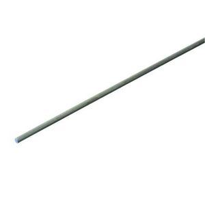

(1) rod 18inches - strong one ($5)

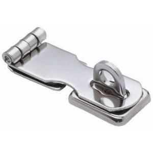

(1) hinge lock ($3)

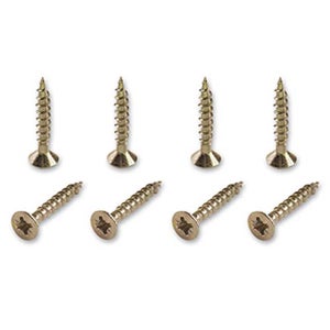

(26) long screws, to secure the panels ($7)
(24) small screws, to secure the corner braces ($3)

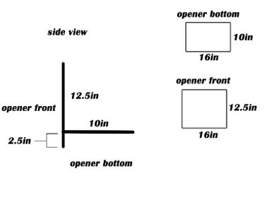

Step 3: Wood Wood Wood and Making Opener
The opener is 2 pieces of wood put together at a 90 degree angle.
The 2 pieces of wood have
3 corner braces on the inside of the opener.
3 corner braces on the outside of the opener.
5 eye screws on the outside of the opener.

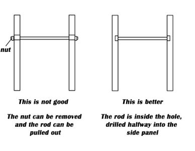

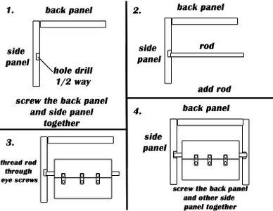

Step 4: Putting Rod and Opener in the Box
I made the mistake of drilling through both side panels to put the rod inside. Now I need nuts to keep the rod inside. Also people can take out the nuts and pull out the rod.
A better solution is drilling halfway into the side panel from the inside and fit the rod in the 2 holes.
That means
1. screw the back panel and side panel together.
2. put the rod inside.
3.thread the rod through the eye screws on the opener.
4. screw the second side panel to the back panel.

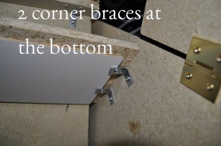

Step 5: Adding the Blocker
Screw on the blocker at an upward angle with the corner braces.
I put 1 corner brace at the top and 2 on the bottom for each side.
