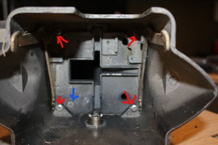

With mine there was a a few levers with springs that can be removed in order to get at the screws that hold everything down. This allows for easier cleaning. After this step I don't put the front screws back in for easier removal later. Take out all 4 screws and repeat for the other side if needed. Once this is done you can pull everything up.
With mine there are 2 more screws that are attached (sometimes) to a plastic cone that collects the coins. I take these out at this point so it doesn't scratch or poke at anything when cleaning.
