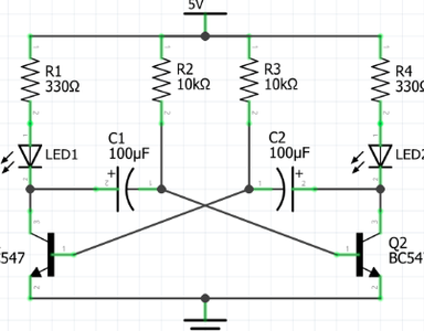

So as I said we will being with the multivibrator part of the circuit. This section will give us a set of two blinking led's, allowing for a more realistic parking pas experience. For this we will need, (2) NPN transistors, (2) 330 ohm resistors, (2) 10k ohm resistors, (2) capacitors, and 2 led's.
Step 2: Wiring Multivibrator
To wire the multivibrator we must do the following:
- Connect 330 ohm resistors on the power rail, to cathode (pos) of both led's.
- Connect cathode (pos) of both capacitors to 10 k ohm resistors in the power rail.
- Connect anode of both capacitors (neg) to anode of led's.
- Connect anode of led legs to collectors of NPN's
- Connect cathode of capacitors to base of NPN's
- Connect emitter to ground (negative) for NPN's
This creates the Negative, Positive, Negative function of an NPN.
No code is needed for this part of the circuit.

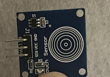

Step 4: Touch Switch
For touch switch all you need to do is connect power, ground, and a pin#,aka the signal. I made this pin 2. For the placement of the touch switch I wanted it to be accessible for any "driver" coming by.
Once this is done you can upload a code and whenever you make contact with the touch switch your function will operate. In this case my servo arm will turn 90 degrees (indicating the process of purchase) making an opening to pass.

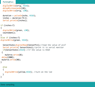

Step 7: CODE
The last step is the code. Upload this and create your circuit!! You can also create a prop and make this look realistic.
