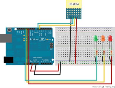

Step 2: Setting Up Hardware
The arduino and the ultrasonic sensor HC-SR04 is connected as shown in the diagram. The coding part for 'em is done using arduino software. You can find the files here. The number of sensors that can be integrated is left upto you. Use this as a template for it.
