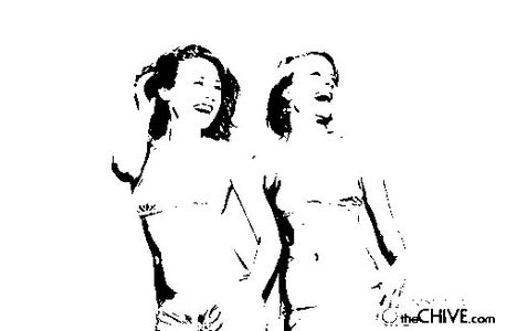

Turn off the visibility of the first two layers,that is,background and the first copy after it by clicking on the eye icon next to each layer. With the top most layer (copy two) selected, head on up to Image on the menu bar, select Adjustments > Threshold.
The idea here is to set the value of the Threshold Level low so we can just have a slight or basic outline of the image. For this image i will be using a Threshold value of 125. Don't forget to check the preview box so that you can see how much of the effect you are applying.
Click OK.
Click OK.

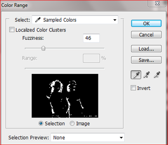

Next go to Select > Color Range.
Once the dialogue box appears just click the white areas of the image to select it and then click OK. What you should now see are lines of marching ants around the black parts of the image indicating the white areas you just selected.
Go ahead and hit Backspace or the Delete key to clear the white areas and what remains is the black areas of the image.

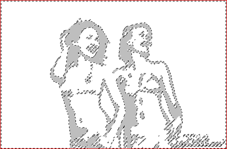

Now just repeat the previous instructions for the first copy.
Remember: Turn of the visibility of the top most layer, turn on the visibility of copy one and select the copy one layer.
For copy one, i used a higher threshold value to really highlight the key features of the two women and for that i used a value of 155.
Press "Ctrl+D" to deselect everything.

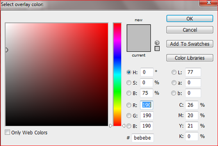

When you've completed copy one, double click the copy one layer to open up the layer styles dialogue box. Here we are going to change the color overlay to a light grey color to give it a good contrast against the black of copy two.
So, select Color Overlay and and click the color box to change the color.
I'm using #bebebe.
I'm using #bebebe.
