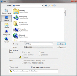

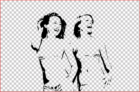

We need to save this image in a PNG format so we can preserve the transparent background so head on up to the menu bar File > Save As or (Shift + Ctrl + S) for the keyboard shortcut.
Give your image a name and change the Format by clicking on the drop down Format menu and selecting PNG. Leave all other default settings unchanged and hit Save.

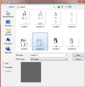

To import the images into Illustrator go to File > Place
In the Place Dialogue box, navigate to the location of your saved images click on either of your images and click Place.
Note: I prefer to place the images according to the way they were created in Photoshop; that is, black on top and grey underneath. You could also place the black image first and just correct the layer order later on.
We’ll be working on each layer one at a time so just place only one image at first.

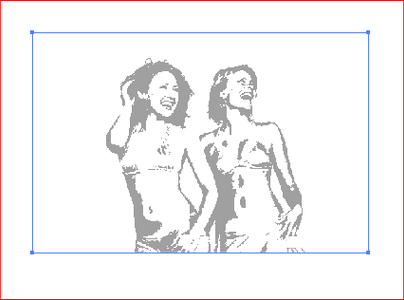

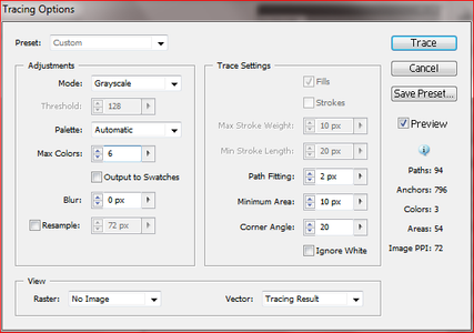

Step 3: Step 3: Converting Your Image Into a Vector Using Live Trace
Now comes the part where we make our image look cleaner and smoother by making it a vector. To do that, go to Object > Live Trace > Tracing Options
Note: Ensure your image is selected so you can apply the changes as you make them and view them when we preview it in the Live Trace Dialogue Box.
First check the Preview box. We want to see the changes as we make them.

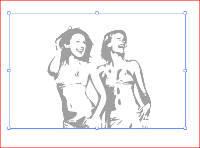

Next, select Grayscale from the Mode drop down menu under the Adjustments section. Leave all other default fields unchanged. And click Trace.
This is the result, a cleaner, smoother image.

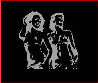

Now hit delete or backspace to clear the white areas and you should be left with just the grey areas.
Note: I put in a black background to show that all white areas have been removed.

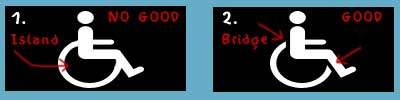

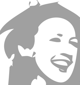

We are going to check for ‘islands’. Now islands are areas of an image that are trapped or closed in by another. Like my image below:
So if I cut away the grey areas surrounding her face, she will have no face.

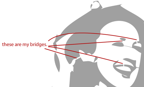

The grey areas are the areas I’m going to cut out, so I need to make sure that no white areas are enclosed by the grey. So in order for me to do that, I need to create ‘bridges’ (breaks).
The image of the wheel chair demonstrates the idea of creating bridges so that there are no islands. You can see on picture 1 that if I cut out the white region I would lose the wheel. In picture 2 you can see the bridges (breaks) which stop the loss of the wheel detail.
Bridges also make your stencil stronger. If you have large areas to cut out you might want to consider adding bridges to maintain the strength of the stencil.

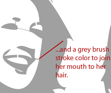

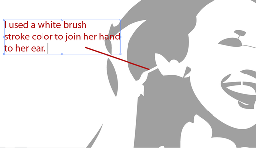

So to create a bridge, just use your Brush Tool (B) to create joining lines. Also ensure your fill color is turned off and only your stroke color is turned on.
Note: Use the same brush stroke color to join an area of the same color. So if you’re joining a white area to another white area, use a white brush stroke color. Likewise use a grey brush stroke color to join one grey area to another.
Refer to my images.
Refer to my images.
