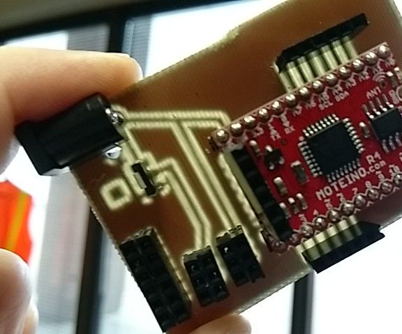

Dollar Store (or similar) = cheap components and housings.I picked up a handful of these usb adapters and a couple of housings. (shown above)
- Housing (from $1 store)This is an LED wall plug night light with some paint and the insides pulled out.
- 110 VAC to 5 VDC adapter (from $1 store)
- 5 VDC to 3.3 VDC adapter
- spare 110v plug cord
- DHT11 Temperature and Relative Humidity Sensor
- HC-SR501 Pyroelectric Infrared Sensor
- ESP8266 Serial WIFI Wireless

Step 4: Build Your ESP Node
Disclaimer - Serious injuries and even death can occur if you don’t take the proper precautions.
- Disassemble the USB adapter to power the ESP
- Solder the power cord to the appropriate wires of the USB power adapter
- Remove the female USB receiver from the USB power adapter board
- Use a Voltmeter to identify the the 5 VDC positive and negative leads on the USB power adapter board
- Connect the 5 VDC wires to the 5 VDC -> 3.3 VDC Voltage Regulator (in)
- Use the 5 VDC to power the PIR module
- Use the 3.3 VDC to power the DHT 11 and ESP
- ESP diagram (above)
- GND - 3.3 negative
- VCC - 3.3 positive
- CH_PD - 3.3 positive
- GPIO 0 - PIR out
- GPIO 2 - DHT out
