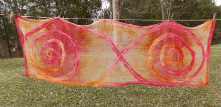

What is Nuno Felting? It’s a fabric felting technique developed by fiber artist Polly Stirling where wool or fiber is felted through an open weave type of fabric such as silk chiffon. Almost any open weave fabric will work for nuno felting but obviously, the heavier the fabric, the heavier your final felted piece will be. I usually use silk gauze or chiffon which yields a drapey, lightweight fabric.

Cover your table with plastic and lay down the blind or bubble wrap. This has to be larger than your fabric. Place your gauze or other fabric on top. Now you need to decide on a design. If the edges of your fabric are raw and not hemmed, you may want to cover them with fiber on both sides. This is not necessary for raveling, but it looks more polished. Other than that, the rest is up to you! You can do swirls, straight lines, whatever you want! Begin by drafting or thinning out your roving. I’m using merino wool which comes in a pretty thick roving so it needs to be drafted. You don’t want a glob of thick fiber as that will felt to itself rather than felt through the silk gauze. Take a piece of roving and firmly hold it with one hand. With your other hand, take a hold of the roving about 12″ away and gently pull to thin it out. This takes a bit of practice to get it even. If it breaks, no biggie, you can use small pieces, too. Lay the thinned out roving on your fabric in whatever design you want. I prefer curves to straight lines so I made swirls.

You know what’s next…..throwing! This will full your fiber, meaning it will shrink and complete the felting process. Don’t start throwing until your piece has passed the pinch test! Make sure all of the fiber is holding on to the fabric. Pick up your shawl GENTLY, wad it up and let it fall on the table. No force here, just gently let it drop. Pick it up and drop it again. Do this about 50 to 100 times. After a while, you’ll notice the fibers firming up so you can increase pressure. Now, carefully lay it out and pull apart any areas that are not supposed to be sticking together. You’ll know it when you see it. Continue throwing your scarf until it’s starting to crinkle and pucker. At this point, your shawl is finished. You continue throwing it to add more crinkles, if you wish.
Step 8: Finishing
Rinse out all of the soap and hang your new shawl up to dry! If any of these steps are unclear, please let me know. And if you try this tutorial, please send me a photo of your creation! Have you tried wet felting??
