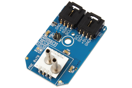

AMS5812 Amplified Pressure Sensor with Analog and Digital Outputs is a high precision sensor with an analog voltage output and digital I2C interface. It combines a piezoresistive sensing element with a signal conditioning element for its operation. Here is the demonstration of using it with particle photon.
Step 1: What You Need..!!
Step 2: Connections:

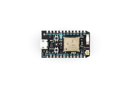

Take an I2C shield for particle photon and gently push it over the pins of particle photon.
Then connect the one end of I2C cable to AMS5812_0050-D-B sensor and the other end to the I2C shield.
Connections are shown in the picture above.
