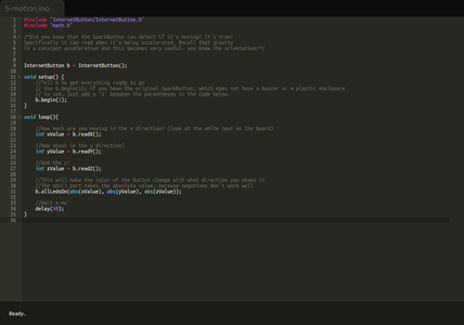

Step 4: Code
The code to be uploaded to core can be found below, it is really simple. Also, feel free to make any modification to the code and leave a comment below if you encounter any error.
If you are using an older version of the internet button (as I am), make sure you change
b.begin();
to
b.begin(1);
<p>#include "InternetButton/InternetButton.h"<br>#include "math.h"</p><p>InternetButton b = InternetButton();</p><p>void setup() {
//Tell b to get everything ready to go
// Use b.begin(1); if you have the original SparkButton, which does not have a buzzer or a plastic enclosure
// to use, just add a '1' between the parentheses in the code below.
b.begin(1);
}</p><p>void loop(){</p><p> //How much are you moving in the x direction? (look at the white text on the board)
int xValue = b.readX();</p><p> //How about in the y direction?
int yValue = b.readY();</p><p> //And the z!
int zValue = b.readZ();</p><p> //This will make the color of the Button change with what direction you shake it
//The abs() part takes the absolute value, because negatives don't work well
b.allLedsOn(abs(xValue), abs(yValue), abs(zValue));</p><p> //Wait a mo'
delay(50);
}</p>
