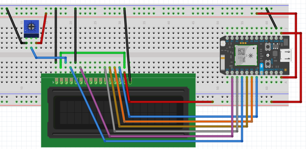

Step 2: Connecting the LCD
Wiring up the LCD is fairly simple. Follow the included diagram and you should get through it in no time.

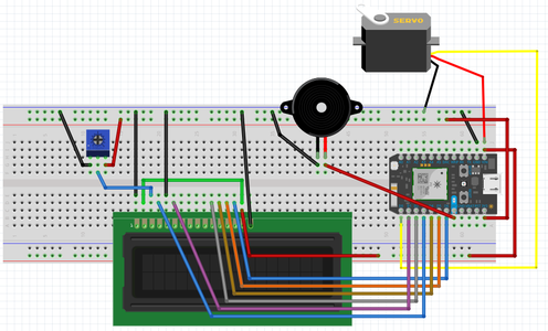

Step 3: Wiring the Piezo Buzzer and Servo
Next, you will want to wire up the piezo buzzer and servo so that when the photon recognizes that the alarm should be going off the buzzer will sound and the servo will rotate, which will turn on the lights.

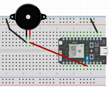

The positive side of the buzzer will be connected to D7 and the negative side to ground.

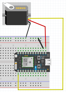

The servo's left most wire will be connected to ground, it's middle wire will be connected to VIN, and the right wire will be connected to D1.
