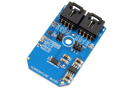

MCP9805 is a memory module digital temperature sensor. It is incorporated with user programmable registers that provide flexibility for temperature sensing applications. This sensor is designed to be incorporated in mobile platform memory module temperature sensor. Here is its demonstration with Particle Photon.

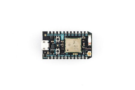

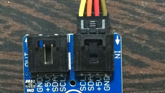

Take an I2C shield for particle photon and gently push it over the pins of particle photon.
Then connect the one end of I2C cable to MCP9805 sensor and the other end to the I2C shield.
Connections are shown in the picture above.
