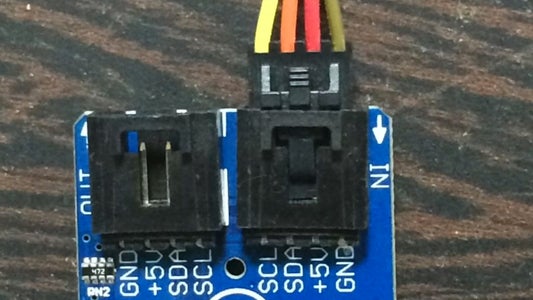

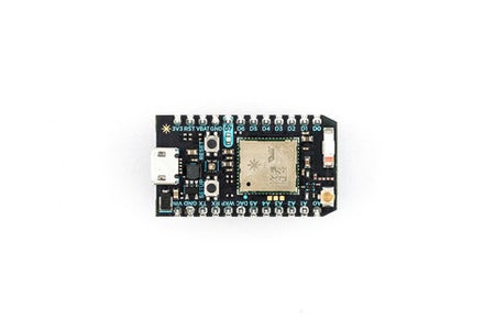

Take an I2C shield for particle photon and gently push it over the pins of particle photon.
Then connect the one end of I2C cable to TMP112 sensor and the other end to the I2C shield.
Connections are shown in the picture above.
