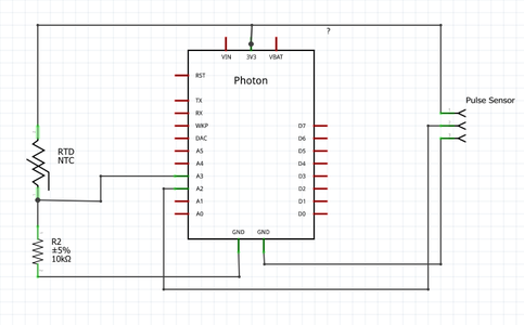

Step 3: Circuit
The circuit is very simple just follow the circuit diagram and assemble it on a bread board. The signal pin of the pulse sensor is connected to the photon analog pin 2, and the temperature sensor is connected to photon analog pin 3.
You must change the code to match the calibration of your temperature sensor, by doing appropriate calibrations to the the variable temp.
