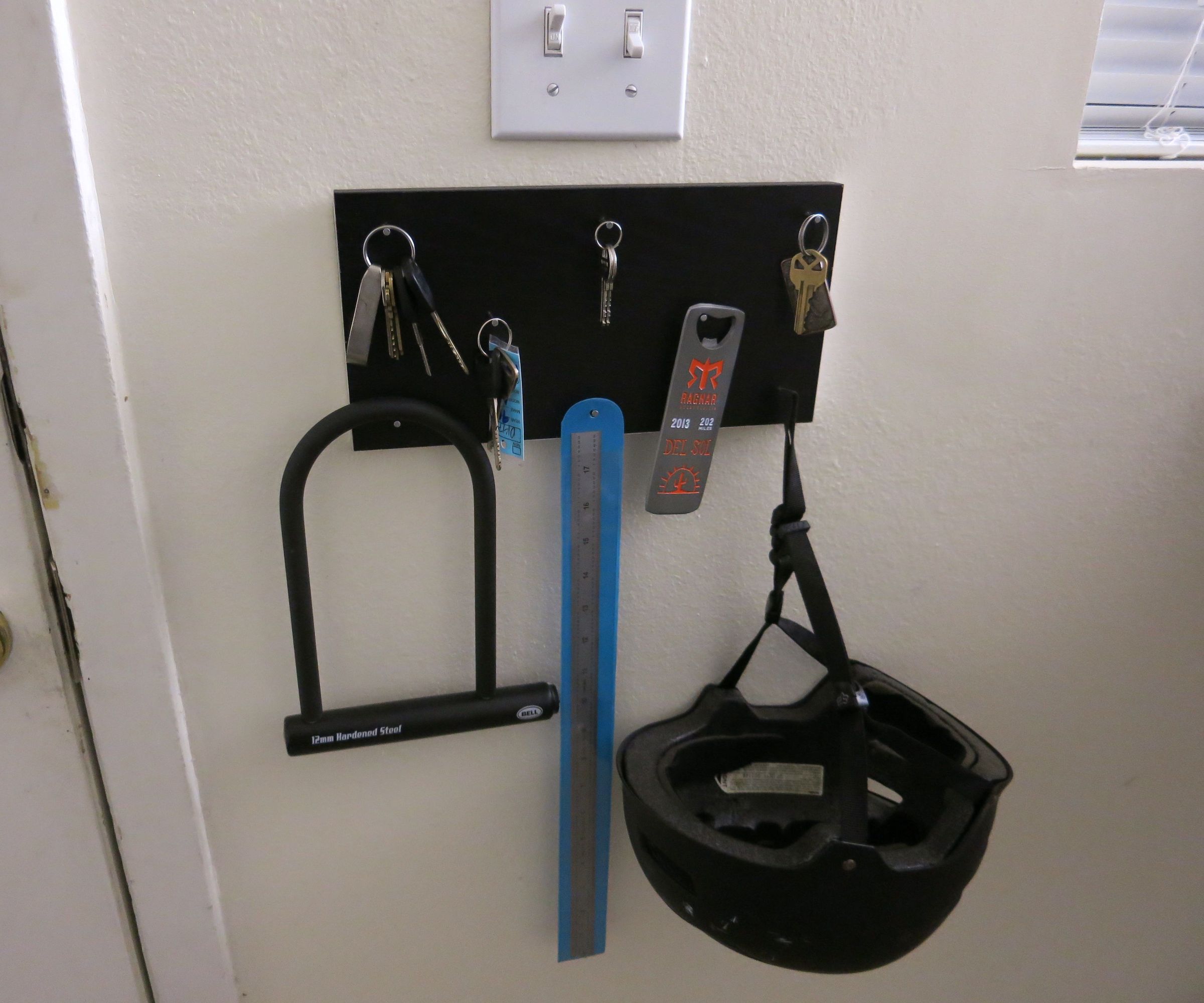

Step 5: Final Product
I like how this has turned out. Clearly I'm no interior designer, but this is functional and does at least three things, really well! I got the plants from Home Depot, and the paper towel rack from Walmart.
