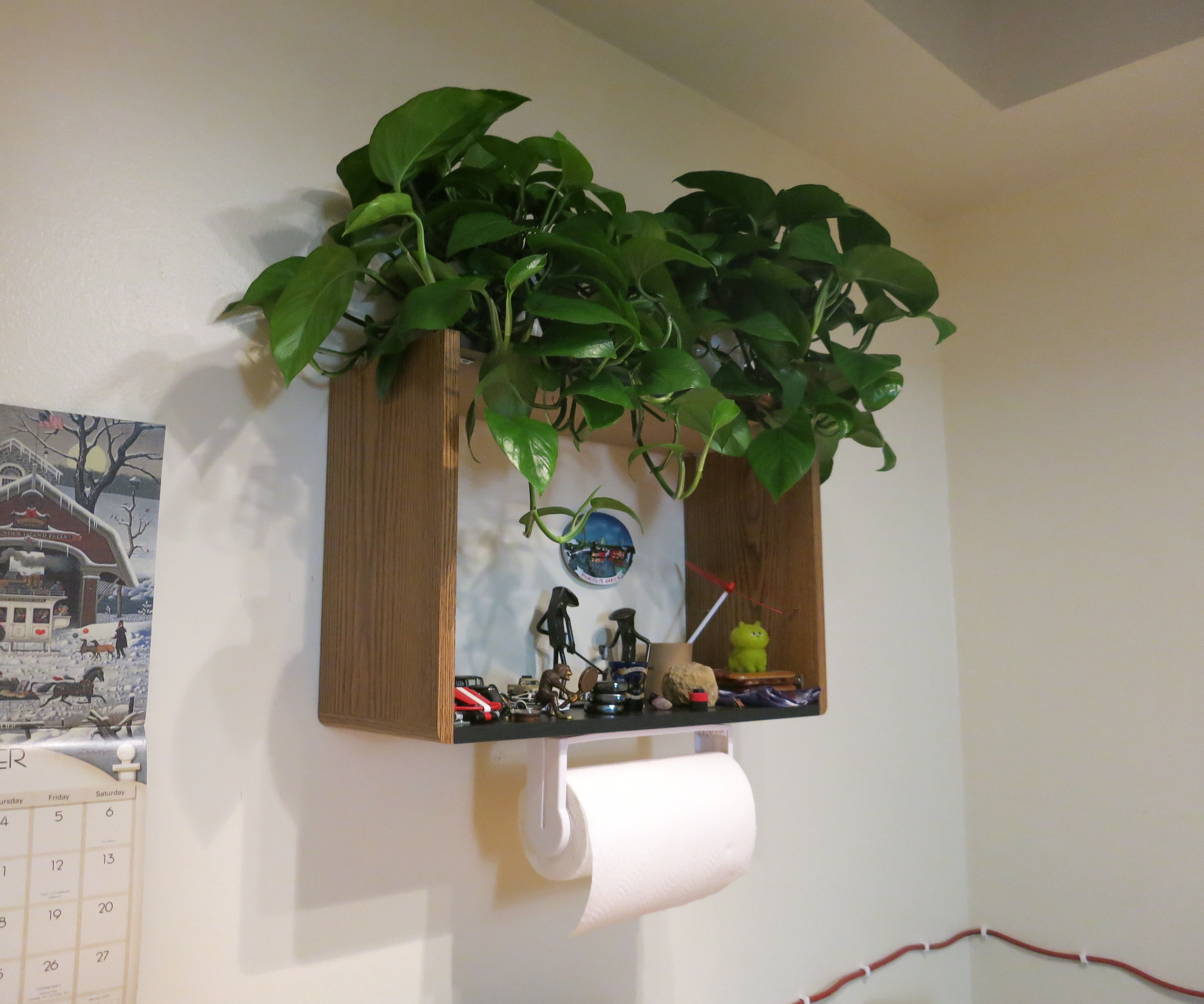

Step 3: Before and After
Making this has changed my life for the better, in a small way. I like that it's sturdy enough to hang some pretty heavy objects, that a store-bought key hanger would not be able to accomodate. Notice how the heavy bike lock is on the left side, without the board tilting towards it.
