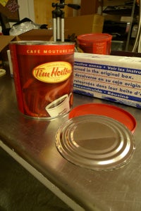

Items required.
Old coffee tin (Keep the can opened lid!)
Long bolt.
Cleaning solution

Items required.
Long bolt.
Cleaning solution

Fold the edges of the can opened lid upwards with a vise or pliers
**be careful of the sharp edge**
Drill 1/4" Hole into the center of the can opened lid.
(then drill several surrounding drain holes)

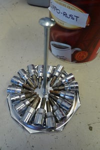

Fasten the end of the bolt to the lid with 2 nuts.

Step 2: Load Cleaning Tray
load cleaning tray with parts.

Step 3: Submerse Parts
Fully submerse the parts in the solution. (Evaporust in this case)
Put the plastic lid on.
set aside.
Just use the bolt head at the top to pull the parts out and dry.
