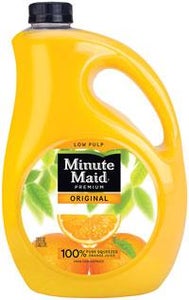

Make very functional parts storage from plastic already in the recycle bin.  Plastic Orange Juice bottles work great.  Also Cat Litter pour containers (jugs) work well.  Containers with a side handle work best.  Using clear plastic is great because you can see much of what's in the container without having to dig or pour it all out.

After removing the label, carefully cut the top off.  You could use a utility knife (be REALLY careful) - i speak from experience on this.  Better yet you could use one of those hot knife cutters.  I don't have one of those but looks like it work really great.  You could use a saw.  I used my compound miter saw.  When cutting take time to survey the design of the bottle.  You want to still have a structurally sound bottle after the cut.  Balance out your desire for large opening with the need for leaving material around the top of the handle.  In the picture, you can see what my bottle looks like before and after the cut.
