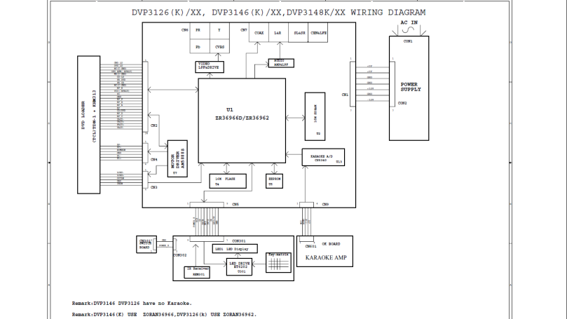

After I unscrewed everything I found a power supply board, a main board that does all the video and audio processing or encoding, a display board that shows the playback time, a mic input board for karaoke and finally the disc tray.
Checkout the image to see the different parts.

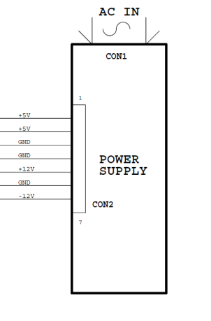

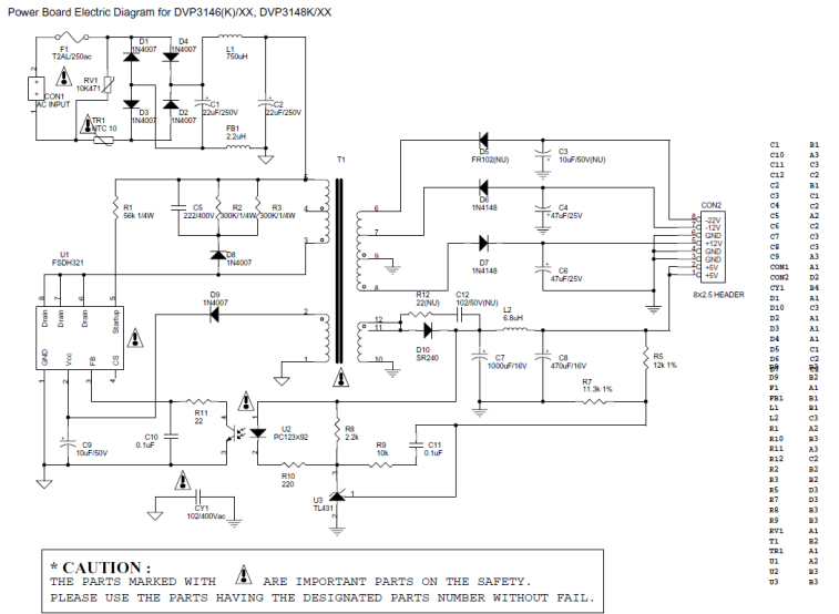

Step 3: The Parts: 1) Power Supply
The power supply is perhaps the best thing to salvage from such a device and is totally worth the time.
From the service manual, I got to know the voltages at the different connector pins.
I was pleased to find 5V, 12V and -12V all regulated DC outputs from a single board.
Uses: I could use this to run opamps that need voltages at both polarities and well I needn't explain the potential use of a 5V supply :P. And all this was present as a single isolated board. From the diagram below it is quite obvious that this is a well designed and stable supply.
Check out this instructable : https://www.instructables.com/id/Easy-variable-voltage-power-supply/

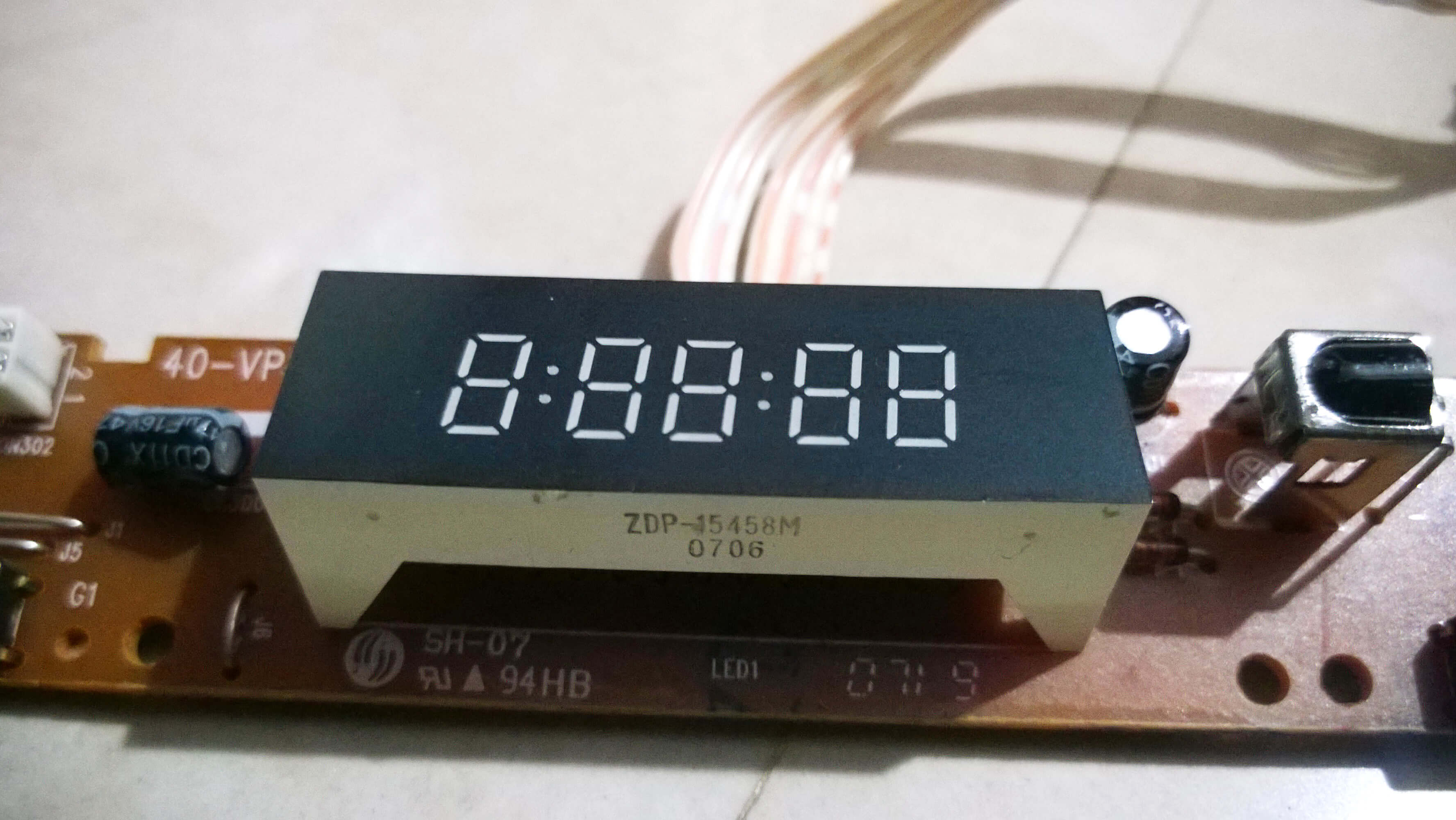

Step 4: 2. Segmented LED Display
Uses: Seven segmented displays are quite useful for different hobby projects including make timers, stopwatches,counters etc. I wanted to make a clock out of it but realized that it only has a single digit for the hour. This was because most CDs/DVDs had space to store only a couple of hours of video, hence it needed only one digit to display the hour. One could still do it just by utilising the 4 digits to the right and avoid showing the seconds.
The display uses an ET6202 LED driver which after a bit of googling appears to have been used with an Arduino too (check this ). So this looks like a good catch!

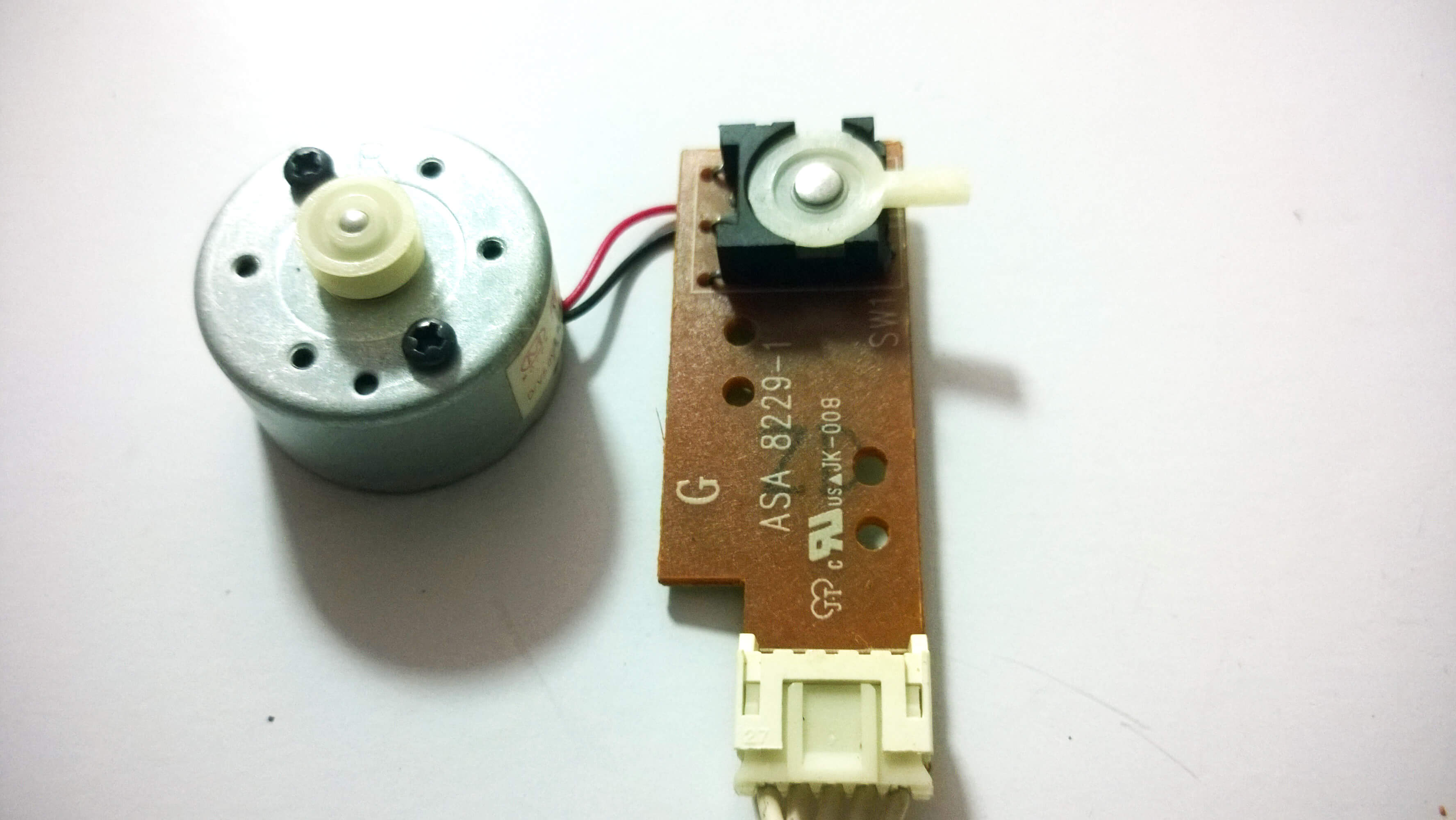

Step 8: Opening Up the DVD Tray: 6. Motors
Took out the tray as a whole and slowly started removing things one by one. It had 3 motors in total :
  1. The one that slides the tray out so that a disc can be inserted
  2. To spin the disc
  3. To move the optical device along the radius of the disc so that all sectors can be read
All 3 were ordinary DC motors (in my case) but it's highly likely to get a BLDC motor from the spinning disc motor.
Uses: I needn't mention any as it's quite obvious.

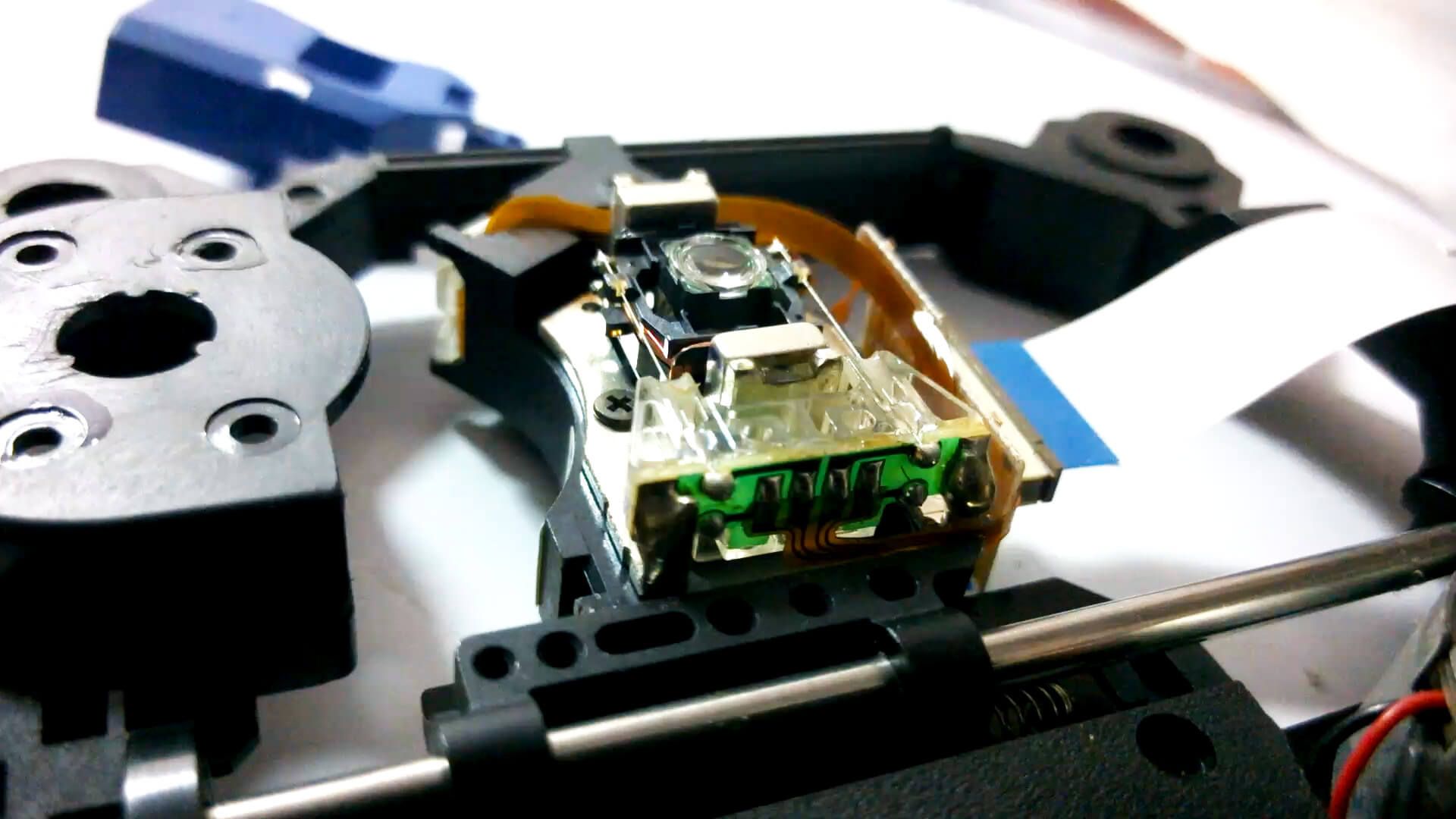

Step 9: 7. Lens, Neodymium Magnets and More…
Took a closer look and found that the optical reader was from SONY.
Check out the above images for information on how to disassemble it.
The lens is suspended by 4 ultrathin wires and is held in between two neodymium magnets. The four wires supply current to the coils that run around it. Check out the video to see how it's held in place.
Putting it to use:
I took the lens out carefully and held it in place just in front of my phone camera to try and see if it augments the camera. Took some macro shots (couldn't find anything so I used my finger) and the results are pretty interesting as I think using the lens brought the focus even closer.
Then curiosity got the best of me and I tried putting the lens above my phone screen to try and see the pixels. The pixels which were otherwise very hard to see were visible. The combination of different hues that make up totally different colours on the screen was quite a sight. (Check out the images for more)

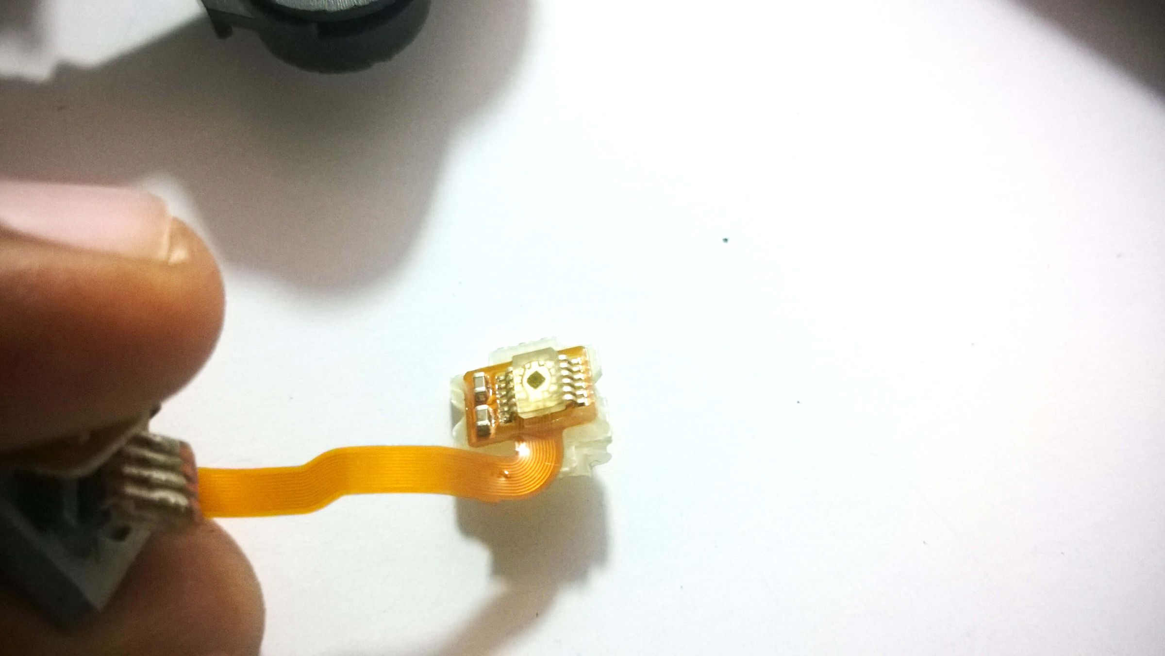

The optical source:
This is what apparently produces the light to read the disc. It after a series of reflections using special mirrors and combination of lens reads data from the disc.
