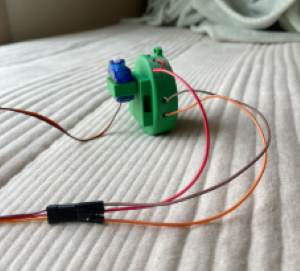

Step 3: SERVO MOTOR
To successfully attach the Servo Motor to the necklace, you first have to attach the Base piece to the CPX case. The Base piece is the piece that the Servo Motor case will attach to, You will do this by gluing the servo motor to the Base that you have just glued to the CPX case. Now you can put the servo motor in the servo motor case (although you might have to hot glue the piece to make sure it is completely stable. In the picture above, you can see the motor successfully attached to the servo motor case and the motor case is attached to the base piece.
