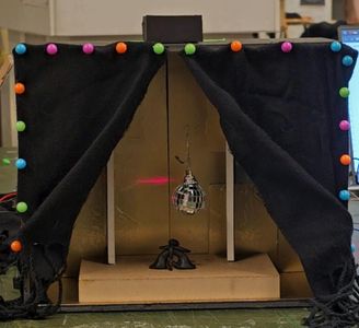

The purpose of this machine is to create an instant party, one that acknowledges that everyone hates when a party get too rowdy and uncontrollable. We made a party that shuts off as soon as it gets too insane. It is like the best part of a beat drop, the rise without the actual drop.
Using a photoresistor to detect as soon as the party gets too dark, the servo motor starts the party and swings a disco ball and an LED shines, lighting up the box. However, when the ball gets too crazy it triggers a motion sensor which turns on a blaring alarm and a laser. The disco ball moves out of the way as it swings, allowing the laser to point directly at a photoresistor, turning off the party.
It's the perfect party! One that immediately shuts down.

Step 4: Building the Stage
First we need a box, sturdy enough to contain the party. A normal cardboard box will work fine but you may build your own. Make sure to leave out one of the faces of the box for the party to be seen.
Step 5: Adding the Servo Motor
Then, we must cut holes in the walls of the box for each of the components. On the top side of the box, there needs to be a slit, cut for the arm of the servo motor. Make sure it is long enough to allow the arm to swing completely.
Insert the servo motor into the slit you have just made and attach a disco ball to its arm using a string. Use an adhesive to attach it the motor to the top of the box so it does not move.
This will allow you to see how low the disco ball will hang, and where the holes for the laser and photoresistor will need to be.
What it does: The motor is programmed to swing the disco ball when the disco ball has little to no motion and is in the way of the laser's beam towards the photoresistor (these components are added in the next step). Essentially, when there is no party detected, that's when the party gets started.
Step 6: Position the Laser and Photoresistor
There will be a photoresistor and a laser-transmit module inserted into either side of the box. It is important that the laser is pointed directly at the photoresistor, with its beam intercepted by the disco ball as it hangs between them.
Cut holes on either side of the box, making sure they are levelled and in line with where the disco ball will hang at rest.
You may adhere a platform on the outside of the box, underneath the laser module like we did. This is to make sure that the laser always points at the photoresistor.
What do they do: The laser gets triggered when the disco ball swings too hard and is detected by the motion sensor (these components are added in the following steps). If the ball moves out of the way and the laser points at the photoresistor, the party turns off and sounds an alarm.
Step 7: LED and Active Buzzer
Using long jumper cables, we wrapped an LED and piezo buzzer around the sides of the box. The wiring connections, as well as these 2 components themselves, will be hidden once the disco box is fully assembled.
What do they do: The LED is programmed to turn on along with the servo motor. This light indicates a safe level of party. The sound buzzer goes off when the motion detector detects the motion of the disco ball (this component is added in the next step). This indicates a dangerous level of party.

What it does: Once the motion sensor detects the disco ball, it triggers the laser as well as an active buzzer. The red lights and blaring alarm indicate that the party is going too hard.
Step 9: Decorate Your Box
We put plasticine people, a stage, gold sheets, and coloured push pins in and around the box. You may decorate the party however you like.

This video is an early iteration of our party machine. We decided to use a stiffer material for the string which the disco ball hangs from. Due to this, the disco ball would swing more. Although funny, the ball continuously hitting the box would displace the laser module, moving the beam away from the photoresistor and it was breaking down our box. This party would have gone on until it wore itself down.
It also caused our servo motor to spin 360 degrees, wrapping the string around itself and failing to function normally afterwards.
Experiment with different levels of party. You may change the string material to make the motion of the disco ball more chaotic. You may also position the motion sensor closer or further away. You might even decide to not include a motion sensor, laser, photoresistor, or alarm and have yourself a party bender.
