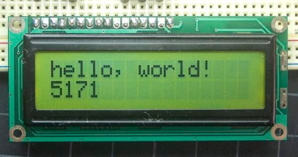

Copy and paste it in an arduino environment window, make sure you have the board and serial port set correct and click UPLOAD after you plug in the usb with the arduino.
You will see the TX and RX led's blinking, that means the code is going to the arduino.
push the reset botton once on the arduino, tune the contrast, and you should see Hello World displayed.
Congratulations! You've got the LCD working! :)

Give it a test: type 4321 then press #.
You should see the message VALID PASSWORD Welcome
After that the LED on the arduino board will light up for a short time. you can put a lock, or a solenoid instead of the led and there you have it: The Arduino Passcode lock
