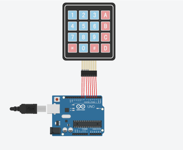

Step 1: Keypad
First, you want to wire up the keypad. Pretty much, you want to start at D9, and keep going until you run out of slots on the keypad.

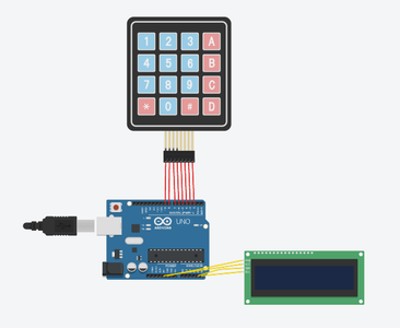

Step 2: LCD
Now, we want to wire up our LCD. This is quite simple. Wire GND to the GND pin, VCC to the 5V Pin. Now, the SDA and the SCL pins don't have a label, but SCL is the closest to the reset button (on the R3), and SDA is right beside SCL.
