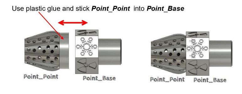

Step 2: Glue the Part Point_Point Into Point_Base
Use plastic glue and stick the printed parts Point_Point into Point_Base.

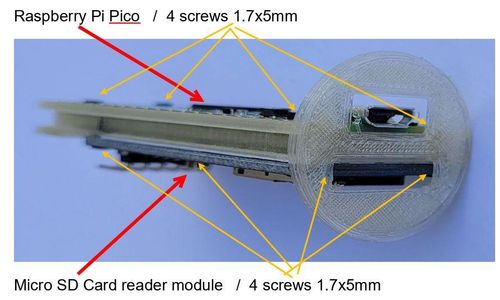

Step 3: Mount Pico & SDCard Reader
Take 8 of the 1.7x5mm screws and mount the Pico and the micro SD card reader module to the Pico SDCard-Holder.

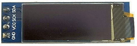

Step 4: OLDE Display
Solder approx. 15cm long wires on the OLED display
Black wire on GND
Orange wire on VCC
Yellow wire on SCL
Green wire on SDA
The position of the BUS PIN might be different to the picture. Check the labeling on the pins while soldering the wires.
Use two component epoxy adhesives and glue the OLED Display into the OLED Display-Holder. Pay attention not to get any glue on the display that’s visible.

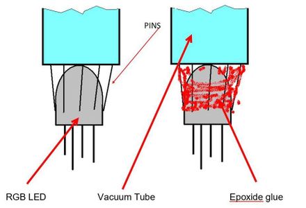

Step 5: RGB LED on Vacuum Tube
Take the Vacuum Tube and the RGB LED.
Bend the pins at the Vacuum Tube with pliers, so that the RGB LED has a tight fit and stays in place.
Use two component epoxy adhesives and secure the RGB LED to the Vacuum Tube.

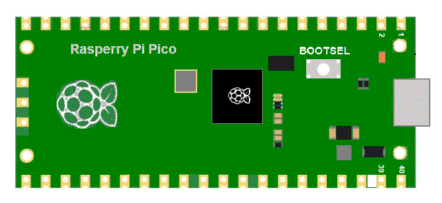

Step 6: Connect PICO & SD-Card Reader
Solder the connections with some short wires on the Pico to the SD Card-Holder.

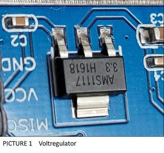

Check the SD-Card module for this little part (see Picture 1) on the backside.
This is a voltage regulator to 3.3 Volt. If this part is on the module, you can connect the VCC pin to 5 Volt. If it’s missing you have a 3.3 Volt model. In this case connect the VCC pin to 3.3 Volt on the Pico.
PICO PIN   ______ SD CARD READER PIN
PIN 8 GND  ---------------------- GND
PIN 39 VSYS  ------------------  VCC
PIN 12  --------------------------  MISO
PIN 11 --------------------------   MOSI
PIN 10 -------------------------- SCK
PIN 13 --------------------------- CS
Make sure you check the SD Card Reader pins, the location of the BUS PINS might be different to the picture here.
Guide the wires for the connection over the backside of the Holder-plate. (see Picture 2)
The side "rail" must stay clear for sliding it in the tube.

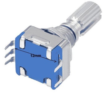

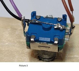

Step 7: Rotary Switch
Take the Rotary Switch and solder the middle Pin to one of the two pins of the opposite side. (See picture 3)
Attach a black wire, approximate 15cm long.
Solder two 15cm long wires of the same color on outside of the 3 pins. (Brown) Solder one 15cm long wire of a different color on the empty pin of other side. (Violet at the push-button function)
Mount the rotary button now on the Tube in the round hole and secure it with the nut. (The wires go in the opposite directions of the OLED Frame hole) (See picture 4)

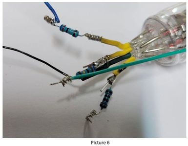

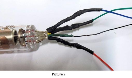

Step 8: Solder Up RGB LED
Meanwhile the glue on the Vacuum Tube and RGB LED should be dry.

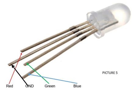

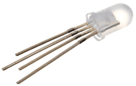

First check the pins of the RGB LED.The longest pin usually is GND.
Check your LED:
Use 5 Volt and a 1k resistor, to check the pins.

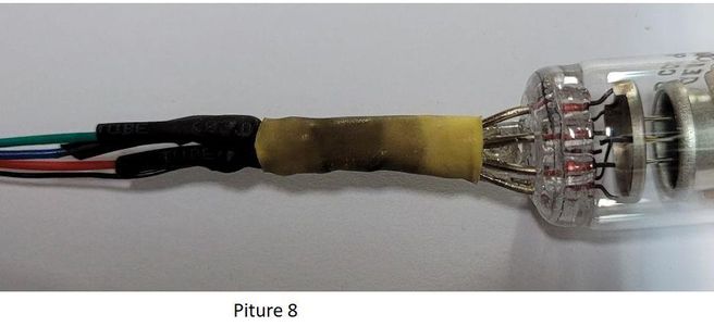

Once the pins and colors are worked out, solder approx. 15cm long wires and the resistors to the pins of the LED.
Black wire to the GND pin of the LED.
Solder the 120 Ohm resistor to the RED pin and a red wire to the other end of the resistor.
Blue and Green each need a 60 Ohm resistor....
Secure the solder connections with Heat-shrinkable tubing.
With this resistor values the LED should get approx. 10mA power. You might alter the resistor values according to your LED brightness. But don’t go over 20mA.

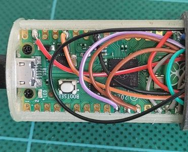

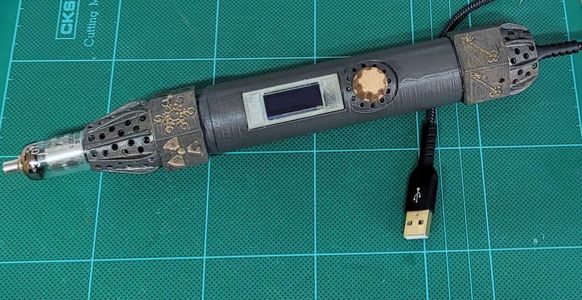

Step 11: Finishing the Hardware Work
Now move the Pico SD Card-Holder as close as possible to the end of the USB part of the PWT_Body.
Trim the wires and solder them straight on to the Pico according to the main sketch.
Once that is done, slide the Pico SDCard-Holder into the PWT_Body.
Use the small rail on the wall, inside the tube, to guide the Pico SDCard-Holder. Make sure all the wires slide in behind the USB port.
Slide on the LID_USB part and secure itwith 3 screws. (Optional, you can also use a small strip of paper or a bit of paint, to give it a tight fit. It should stay removable to get access to the SD-Card).
The hardware part is done now.

Password Safe display is dark.
Check if SCL is on GP15 and SDA is on GP14
