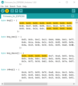

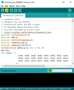

Step 7: Modify the Firmware
Open the file Firmware_for_ESP8266.ino and replace the existing keys with those you've generated.
Don't modify the parts of the key highlighted by yellow. Those parts are getting filled up when you approximate cards to the RFID reader.
If you want to create your color scheme, you can find the color converter here https://chrishewett.com/blog/true-rgb565-colour-pi...

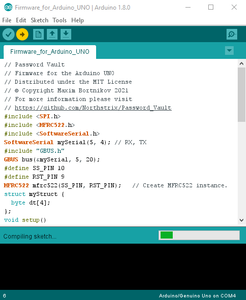

Step 8: Flash the Arduino UNO
Upload the firmware from the folder Firmware_for_Arduino_UNO into the Arduino UNO.
Step 9: Flash the ESP8266
Upload the modified firmware from the folder Firmware_for_ESP8266 into the ESP8266.

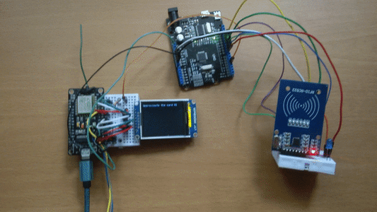

Step 10: Build the Device
It turned out that the schematic diagram for this device will be tangled up and barely readable. So, I only included the circuit diagram.

Step 12: Power Up the Device and Open the Serial Monitor
Power up the device, open the Serial Monitor and set the baud rate to 115200.
You might've noticed a 3.5 mm jack socket. It's a remnant from one of the previous projects.

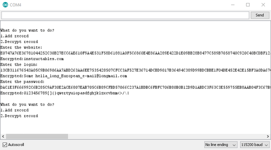

It's time to encrypt something. Enter 1 to the Serial Monitor and press Send.
Now, you'll see the instructions in both the Serial Monitor and the display. Start entering the website, login, and password one after another. If you enter something longer than 48 characters, everything after the 48th character won't be passed to the function. You can also see what's been encrypted in the Serial Monitor.
I obtained these results:
Encrypted website:
E0747A76E36781044252C30B27ECC6AE610F9A4E531F58D61881A0F5C6860E4E86AA289E422D1E09BB28B8477C589B7058740C920C40BCDBF1253B60D5F8CBC0EB06AF5A9899DAC16A4BC047C01F2ECCFE514486B9CB6DDA873AB55E567669C4C8FE5DDB3E073A4B8E09CAF8334C31017DE0C609D603A7D3
Encrypted login:
13CB311676543A05C9B06906AA7ABD263AA6EE7535428507CFCC3AF527E36714DCBD9017B36494C389D99BDCBBE1F04DE452E42E15BF3A0DA67C3901D5D4B348AD06A3B39F64B7E8B21D0E5336BD7170ED8938C08F4576655273378B8740ADEB05C4D6D4B5D516AE076FB12FE63CC0EE2A354F7E3614237B6A2574D1B774D7B25014D89BB314E8E097D4D4188645213944491A86D4B69916F23C7FB13177EDE98ABE9DFFE2B2FE9D7E33B23E6377D1C41B2054D1A0F62A46EB95DDE6C10E465922256562DE76304AC87B25ACCA861B7FBD86FF32AD631EDB7FAECAC7ADBCF4B846F4665235A0F541B40C41E231897374
Encrypted password:
DAC1E3F666992C6B285C9AF30E2ACE6807EAB705C6B89CFBD57066C237A1BDBC6FBFC706B80B0B12D9D1ABDC3F63C3E559755EB8AAB04F3C67B829B74559F32FE0D00C5696234775E7E3AA977A16296E15801D6017D63EF63F2A373ECAD7401FE6D7ADAD48B269BE8511189C381D9201C0FE36870EDA9A2896D904FD79E4D992998F7683FBC44ADE04887AD177F695CE13B62F76DFB9016B4B5E0B349574557FF2079C36380F29332C2F975BD31C1F09F97DAD72F4DF04865B07DF8800E0F500783567906FE97668A95F4EB47A1D0C8BA6CA502C82AF8FA00B45AB356D201BFFA9D3A5697D8B0E8B34901235F0CEE2B4
Login and password are fictional (just in case).

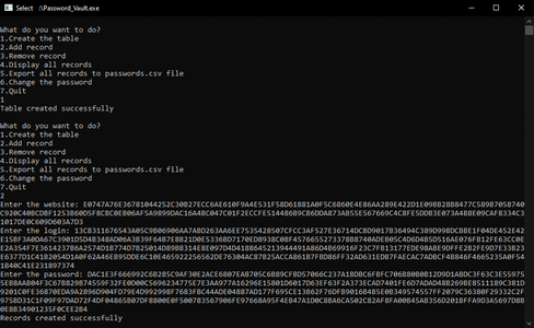

Step 16: Add the Encrypted Record to the Database
I know this device is supposed to store the encrypted data in the internal memory. But I haven't figured out an efficient way to organize a file system, and more importantly, I haven't figured out how to remove a record without erasing everything. To solve this problem and to also solve the problem of the limited space, I wrote a program to store the encrypted stuff.
You can find this program in the Software/Password_Vault folder. The source code is in that folder too.
If you're launching this program for the first time, press 1 to create the SQL table.
Press 2 to add a record.
Press 3 and enter the encrypted website to remove the record.
Don't forget to press Enter when you made your choice.
Step 17: Export the Encrypted Data to the .csv File
You can export all records into a .csv file. To do this, press 5 and then press Enter.
If you prefer to copy the data from the command prompt or want to see all records without exporting them, then press 4.
