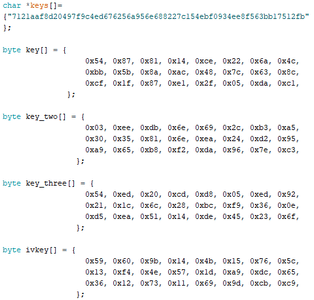

Step 6: Generate the Keys
You can do it by any means possible.
The best way to do it is to throw 20-sided dice.
If you get a number from 1 to 9, write it down. If you get a number from 10 to 15, write down a letter corresponding to that number.
10 = A;
11 = B;
12 = C;
13 = D;
14 = E;
15 = F.
If you get 20, write down 0.
If you get something else, don't write anything and throw the dice again.
Since I'm going to expose the keys to the whole world, I've used a weak RNG to generate the keys, don't ever do that! That will compromise the security of the device.

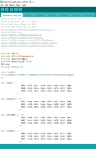

Step 7: Modify the Firmware
Open the file Password_vault_two.ino and replace the existing keys with those you've generated.
By the way, If you want to create your color scheme you can find the color converter here https://chrishewett.com/blog/true-rgb565-colour-pi...

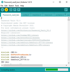

Step 8: Flash the ESP8266
Upload the modified firmware from the folder Password_vault_two into the ESP8266.

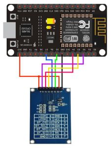

Step 9: Build the Device
The circuit is so simple that I've decided not to include the schematic diagram.
Ignore the protruding gray wire. It's +5V.
Step 10: Circuit Diagram

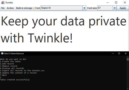

Step 13: Save the Ciphertexts
Technically, the word vault implies that the device has some form of storage, and without storage, it's just an encoder and decoder of your precious passwords. But I haven't figured out an efficient way to organize a file system. And for now, the external storage serves as a vault for the already encrypted passwords.
It's up to you where to store the ciphertexts. I can only suggest Twinkle or a database from one of my previous project.
If you have anything better than that, don't hesitate to use it.
