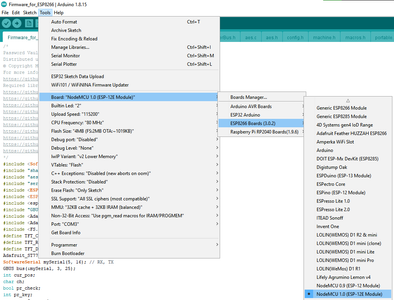

Step 3: Install Drivers and Configure Arduino IDE *Optional
If you've never flashed ESP32 or ESP8266 before you'll need to configure Arduino IDE and install drivers to upload the firmware to the boards, you can find drivers here:

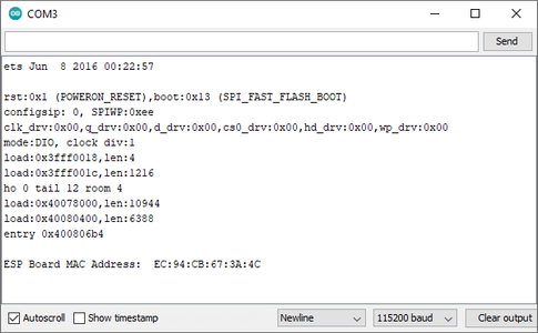

Step 7: Get the MAC Address of the ESP32
To get the MAC address of the ESP32 upload this code into the board.
#include <WiFi.h>
void setup(){
  Serial.begin(115200);
  Serial.println();
  Serial.print("ESP Board MAC Address:  ");
  Serial.println(WiFi.macAddress());
void loop(){
Then open the Serial Monitor, and reboot the board.
If done correctly, you should see the MAC address in the console.
The MAC address of this board is EC:94:CB:67:3A:4C

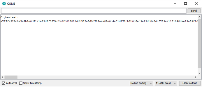

Step 19: Encrypt Password
First of all, open the Serial Monitor because the ciphertext is printed into the Serial Monitor.
To encrypt a password, select the Encrypt password option in the menu, enter the password on the keyboard, and then press the Enter button on the keyboard to encrypt a password.
Press the Esc button to cancel the operation and get back to the main menu. That applies to all options in the main menu.
Eventually, I came up with these results:
Plaintext:
This version of the password vault is a device that has the capability to encrypt your passwords, store the encrypted passwords in its built-in memory, hash passwords, and securely send passwords to another device.
Ciphertext:
a727fe32fc0a5e9b2e0b71a1ef3d6f3374c2e0fd01f8114db572a5d9d789aea89e0b4a01d172cb8b0d6ec9e13db8e64cf789aa1131048dae19a59f16e7d4f30c637ff263bbc7d6220a3552455613a2f128389ac5f9a52c005befb23846beb1fe4a2a06bd9a4c410eec106800ca0a5f55ab32504abdf66c74cf1bb60f40d3c56d05442be3ab3358c92c02863e7d0d9a06f78581e02e91b3ddfbe98d9b948d87c42f113a6522295361360b6237a49a1a64835585a66b354b829fc5ae00daf420f157e23bffa26aaf84bad55ef60c9f1362e3a596d0265d2c6d6911381dff998af9947a153e2bf1e8093a3098e6c71632be8f15799d681cad8d8bbc58af51b7362877c8e12bcf30daa5b1b29efd70ef7ffeb91f32325cb85028b335de2f5deb052c1a4c901a4873118cee6769f90b8c380d64310addf8250b9502a7fe8c8b1c3daffe3638da709973b5b31984e2bbd2dd1748f4be8c90739f3e9bb902179635e95894a81883e785421e9f265e6a182ddbd1daa95cd9383b52b80cde75330b3ad2e748f65f99b51a70d3a58507544bf2aee154911d723ad0ea09176dc952729d1f3fc62fee18eab7281ef7c4e42588c1a9b624f59369fba4df428a9414fcd4096c5aa91087029de584054d46bd59e06b4f08acbd622aaca9607f6d5ce101a91972ea3d98e5489caa9ec134809ec5cfac1b7c4c537672e16042361dbf0c87c0f90a0ff7df7f2362651cb5c618c25f4f99d8ff2fdac7de4bb5d495dc59f9cb2b15694f8a179ff7187a78d50c6258e4cc7b69418a8c4f7361a92eae9ad41744779f41d95e703f7634c79da747a114c0a6c74e5eb6e82927022270af99589ed3354d3f02bd63d489b56dd715e07206f427debf89ea9ce5dfc657d384ee6ec0822ad2a8ae5c8d3a335329ee9343f778a2be51d358227bc3cf68dc728f2f2ba93aab7fd4e9c932f66507b0b3e9354437fc9fa2f48f94ce22df76b0abb463d4847cf743cf0b6b9117532328538674d2b7eb3066111de993e6ca31ec82216edb9673d8eb9e0352f18acd5a0a43ec6843e9abd31ec40675e5152d6039ad56ff7382e2dca7726116a5684f67a60cdd032fd262991486acb1b583d7d1f234211a7400bfa92e7cad779792365899eec4a3b94b054761c3befff77b12b059af7bb25a7f8f8c6440b5667f19243b3f484552e71b2d47abf427c6a9290130ded6a23bcf627b8ccb3cc3

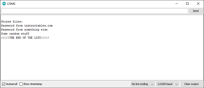

Step 23: List All Stored Records
To list all stored files, open the Serial Monitor, select the List all stored files option in the menu, press the Enter button on the keyboard.
You should see the list of all stored files in the Serial Monitor.

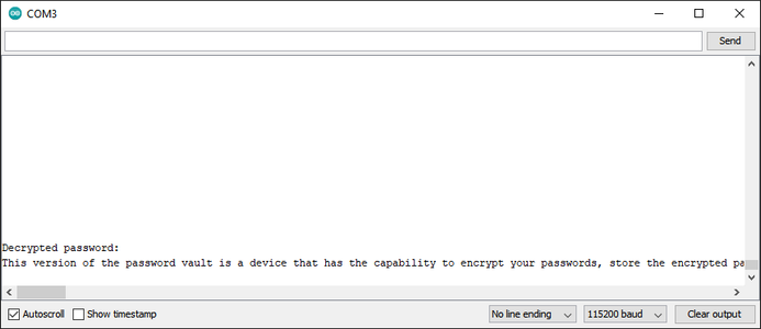

Step 24: Decrypt Password
Let's suppose that a couple of days have passed, and now you need to retrieve your data.
First of all, you need to set the same master password and the initialization vector that you've used at the time of encryption. After that select, the Decrypt password option in the menu, press the Enter button on the keyboard and then paste the ciphertext into the Serial Monitor.
Master password:
Your house might have the best lock in the world, but what's the point in it if you keep the key from it in an easily accessible place.
Verification number:
186
IV:
321654
Ciphertext:
Plaintext:
