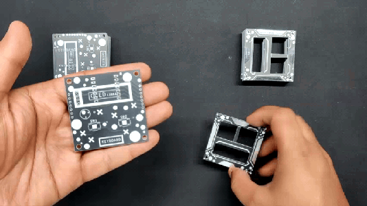

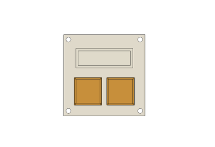

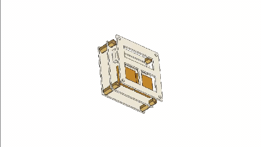

In the beginning, we built the PastPal model utilizing three PCB layers stacked together with eight PCB STANDOFFS: four for connecting the top layer to the mid layer and another four for connecting the mid layer to the base layer.
Three openings have been made on the top layer: two are for the addition of the switch actuator, and one is for the display.
The mid layer has an XIAO microcontroller on the bottom face of the board and SMD switches and a display on the top face.
To enclose the model from the bottom, there is a third layer dubbed the bottom layer.
The switch actuators are modeled and positioned between the switch actuator slots on the top layer and on top of the SMD switch knob.
Since the switch actuator and the switch knob are positioned exactly on top of one another, pressing the switch actuator also presses the knob, resulting in a registered switch click.

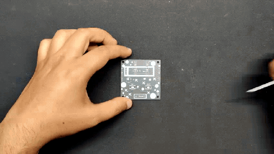

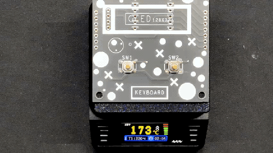

The PCB design for this project was quite easy to interpret; we included an XIAO SAMD21 microcontroller, whose D0 and D1 I/O pins are used to connect it to two SMD switches. Additionally, we integrated an OLED display using XIAO's I2C pins.
Since the SAMD21 microcontroller inside the XIAO is registered as a human interface device (HID), we can create a tiny two-switch keyboard using the Arduino keyboard library.
We made two boards using the model's dimensions: the top layer board and the mid layer board. Since the mid layer board and the bottom layer have the same outline and mounting holes, we will use it for the bottom layer.

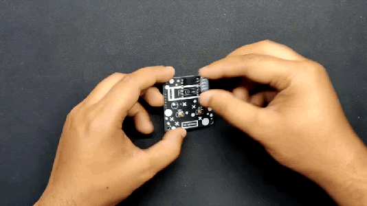

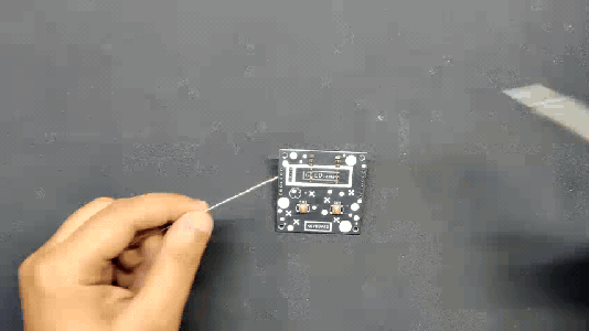

  1. Using a solder paste dispenser needle, we begin the PCB assembly process by putting solder paste on each component pad.
  2. Next, we pick and place the SMD Switch in its location using an ESD Tweezer.

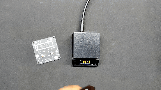

  3. Subsequently, we remove the board and set it on our Reflow Hotplate, which raises the PCB's temperature from below to the point at which the solder paste melts and the SMD components are all connected to their pads.

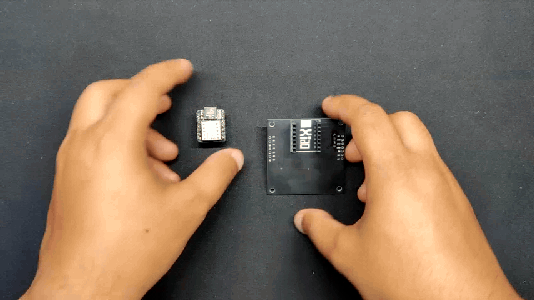

  4. We attached the pads of the two CON7 Female Header Pin connectors that we inserted from the back side of the PCB to the location of the XIAO Microcontroller.
  5. We soldered the OLED into place after adding it from the top side.
Board assembly is now complete.

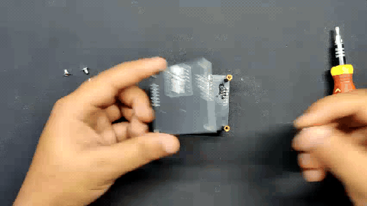

Step 6: Layer Assembly Process

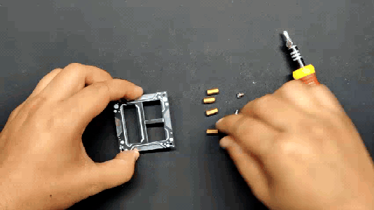

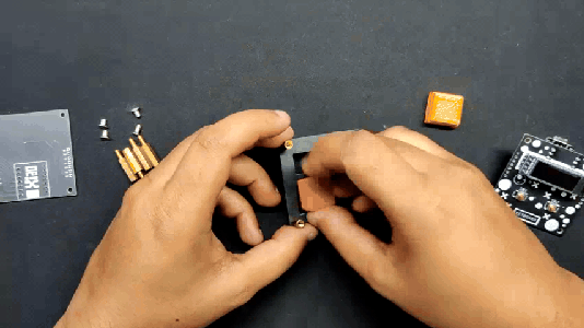

  1. Connecting the 9mm PCB standoffs to the top layer of the board via its four mounting holes is how we begin the layer assembly procedure.
  2. Next, we placed XIAO in its proper spot on the bottom side of the Mid Board.
  3. The top layer board was flipped, and the two 3D printed switches were inserted into their designated slots. Next, the mid layer was positioned from the bottom of the top layer, and the top and mid layer boards were joined together using four 12mm PCB standoffs.
  4. Finally, we position the bottom layer PCB on the standoffs connecting it to the mid layer and fasten it in place with four M3 bolts.
Assembly is now completed.

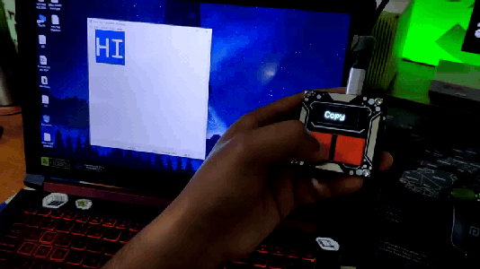

This sketch uses the Adafruit_SSD1306 library to control a small OLED screen and the Keyboard library to send keyboard inputs. Here, this macropad sends copy (Ctrl + C) and paste (Ctrl + V) commands when the respective buttons are pressed. The OLED display is used to show "Copy" or "Paste" for visual feedback whenever the respective button is pressed.

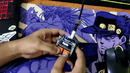

Step 8: RESULT

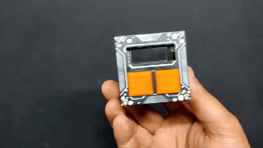

The end result of this quick but interesting project is this: a MACROPAD with two buttons that we have assigned short keys for copying and pasting. Any button can be pressed to see which command is active on the OLED.

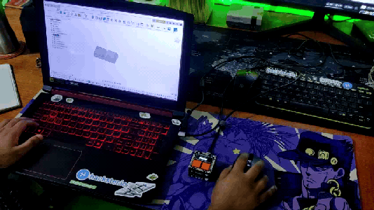

We put this device through several tests. We tried this in a notepad, and we even utilize this macropad in our Fusion360 design process, where we just choose a model and use the copy and paste command to create copies of it.
Depending on the use case, the copy paste command in macropad can even be altered. To do this, we just need to edit the code, which is very simple to achieve.
